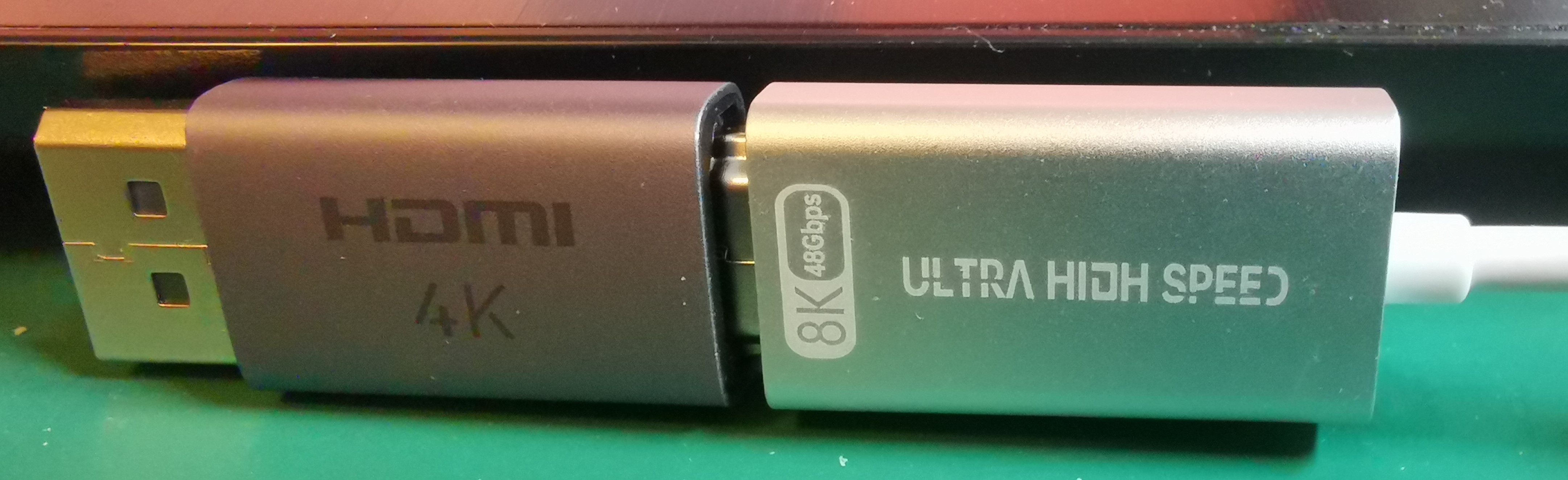

Hooked up a wired keyboard and mouse and booted up, then got 1 long the 3 short beeps on first boot.
I think it may be a graphics card code? The card is seated well.
The only thing I can think of is that I didn't have a dedicated DP to DP cable, but I did have a HDMI to HDMI 4k cable and 2x HDMI to DP 8k adapters which I attached to make up and go from the Graphics card to the back of my Philips monitor. I tried swapping to another DP output on my Graphics card to no avail and the monitor states no input when selecting DP on it.

The 8K HDMI cable works without the adapters though.
I’m not really understanding. How come you’re using Dp adapters? Does the monitor not have HDMI?
You say the cable works without the DP adapter, is that correct?
It's not very clear what you're trying to achieve
And are you definitely plugged into the GPU and not the motherboard?
What's the make and model of the monitor?

You do know that DP-HDMI adapters are typically unidirectional? The are either designed for DP to HDMI only or HDMI to DP only and you cannot use them the other way around.

Yes I just got my new PC, thanks to "Spyder" for the advice on parts. Again I'm not too savvy on modern PCs, and the GFX card (16GB MSI
GEFORCE RTX 4060 Ti VENTUS 2X BLACK OC - HDMI, 3 x DP) does have 1x HDMI port. (Yes I was using the Card and not the MOBO ports)
I thought I'd use one of the GFX Card's DP ports although it was only feeding a Philips 242B monitor that has a standard DP In port also.
(I am planning on getting a 2k 27inch QHD 1440 x 2560 144hz or so though)
IN BRIEF:
I had previously been using the Philips monitor as an extended display from a laptop's mini DP out to the monitors standard DP in before this new desktop set up, to which it is the main sole monitor at present on the new desktop PC. Anyhow...
ERROR:
I had an 8k HDMI cable, and put 2x HDMI to DP adapters on it so I could use the GFX card's DP ports with it. I then got error code beeps. I assume it was because the HDMI lead was 8k and the adapters were 4k so it confused the card?
It did boot up properly after I removed the HDMI to DP adapters and just used the HDMI ports on both the card and monitor.

I think you're getting confused a bit here
Wherever possible, you want to use a native cable without an adapter. Any adapter should be a last resort. You'd only use an adapter if you had a monitor with a port which you didn't have on the PC.
That monitor has both HDMI and DP
You only have an HDMI cable, therefor you should use the HDMI port on the PC to the monitor, or buy a DP cable
PC's primary display output is a display port, HDMI is more designed for home theatre or consoles where you need to carry audio. DP has higher bandwidth generally, that's why the GPU has 3 x DP and one HDMI
