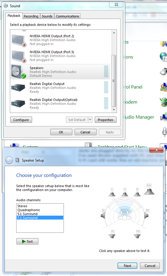

So your getting sound out of all but 2 speakers in a 7.1 setup. Have you pushed all the buttons in Realtek audio manager? I know you said you changed settings in it so I presume you tried everything, But you don't say if it was realtek or windows settings you are using. I only have rubbishy speakers so ic ant test it fully but if you set it to 7.1 you get a bazillion options for enabling and disabling different speakers.
if you go into the hardware and sound section of the control panel, open up manage audio devices then select your speakers with a double click. Are all 3 jacks showing as plugged in? (mine just has 1 labelled rear 3.5 mm jack but I presume you will have more) if so go along to "levels" tab and click the balance button. Are all the sliders set to 100%, or at least not 0? If that all seems ok I would go ahead and click the advanced tab and reset everything to default.
if your still stuck go back and open up the 'manage audio devices' again and click your speakers with a single click and now click 'configure' on the bottom of that page, select 7.1 and configure.

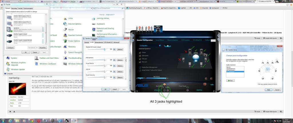

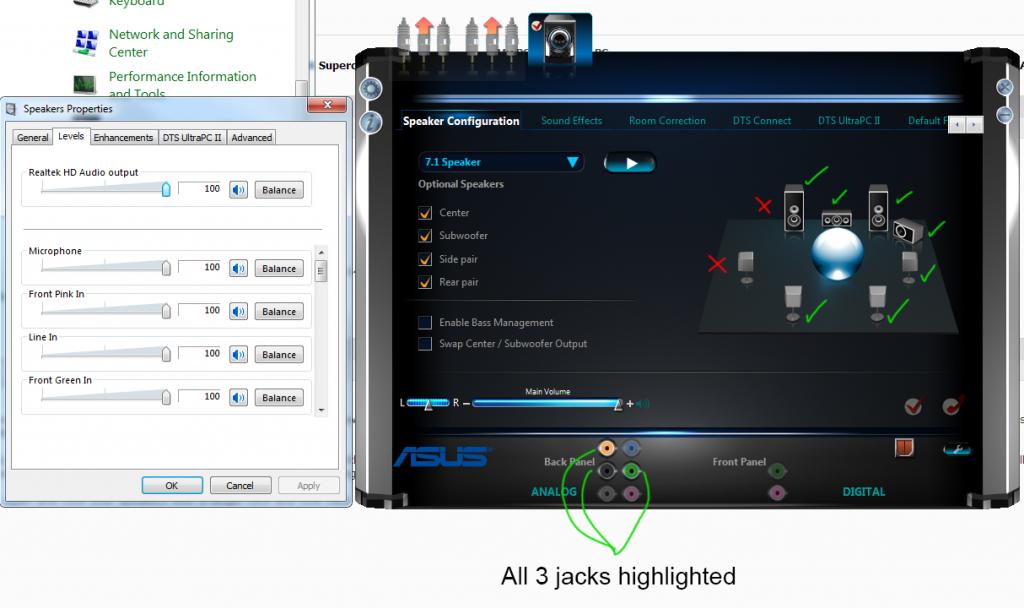

Kveldulv
yeah just 2 speakers out of 7 are not working,
tried everything what you have said before and nothing helped...
