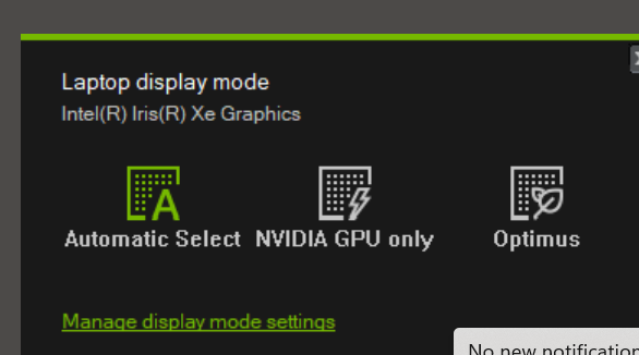

Hi Paul,
Thanks for replying, I appreciate it.
It definitely has Advanced Optimus as it switches between the Intel GPU and the Nvidia dGPU on it's own. The issue I have is with some games it doesn't do it fast enough and functions such as G-Sync don't have time to enable before the game opens.
I have this option (see attached screenshot) in the system tray and in the Nvidia Control Panel 'Manage Displays' section I have three options. Auto select, Optimus and Nvidia GPU only.
