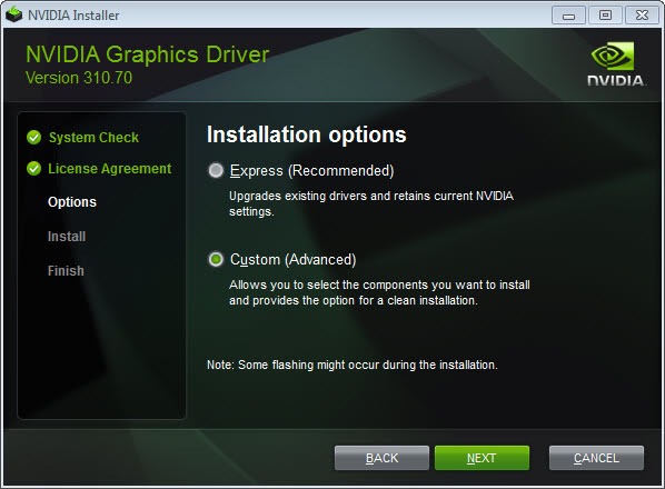

Ok, as a quick attempt at solving it, we can try something easy tonight until Ubuysa comes on tomorrow and checks the dump file.
If you install DDU (display driver uninstaller) this will completely uninstall the GPU driver. Believe it or not, it's one of those programs that doesn't properly uninstall when using the normal program uninstaller in windows:
Run through that, select the nvidia driver to uninstall and it will then reboot the computer to finalise the uninstall.
Then download and install the latest driver from nvidia, do a custom install BUT make sure you DON'T select to install the HD Audio Driver as it's caused issues recently (don't use GeForce Experience for this bit just for the initial install)
Then in future, when updating the driver through GeForce Experience you get to a page where it asks what type of install you want, always select "custom", this fully uninstalls the previous drivers settings rather than overlaying them which can sometimes cause incompatibilities and BSODS
