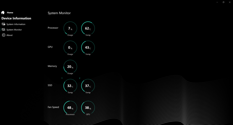

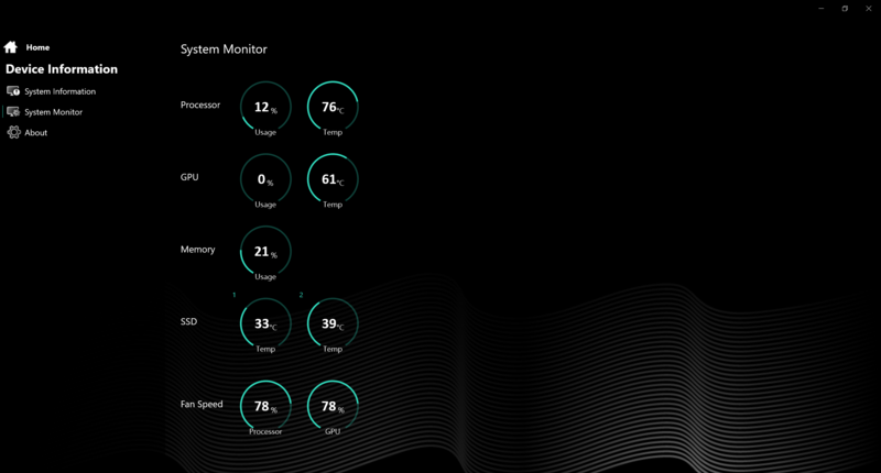

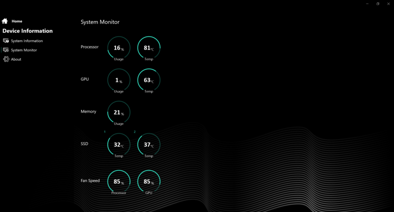

Here's some screenshots taken from Control Centre temperature monitoring.
All the tests were done while my battery was charging, with the cooling pad on my lap and then the laptop itself on top of that. The fan settings in Control Centre are set to Gaming Mode so the fan will be monitored and adjusted automatically by the software within the laptop. The temperatures seem slightly higher than normal due to the battery being charged at the same time.

This is with the cooling pad turned on and after the same conditions as above:
Processor temps around 60-62 degrees but I did see them fluctuate down to 52 degrees after the laptop fans worked a bit more, so I see this as an erroneous reading really. within a couple of minutes after the fans went back down to 30%, it went back up to 60-62 degrees.
GPU stable at 43 degrees.
SSD's stable at 32 and 37.
The fans seemed to be working harder with the cooler as can be seen in the images. SSD temperatures were lower but CPU temps were higher.
I then did some gaming, running Assetto Corsa downloaded and installed via Steam but running it via my desktop shortcut. Pretty much everything turned up to the maximum and getting about 150fps when looking at the performance overlay. Settings maxxed in the game itself and within Nvidia GeForce Experience.
This below is without the cooler turned on, about 10-15 minutes of gaming and just as I quit out of my race and back to a menu, which is why the GPU usage % is low:
The below is with the same conditions as above but with the cooler turned on:
