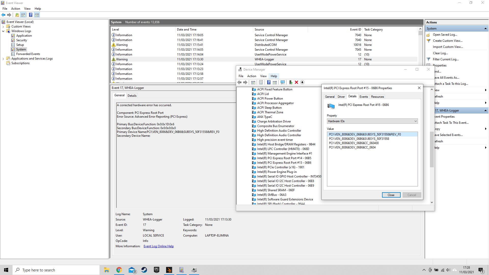

I'm having issues with event ID 17 warning spamming in my event viewer. I first noticed it from HWinfo as it was capturing the errors at the bottom.

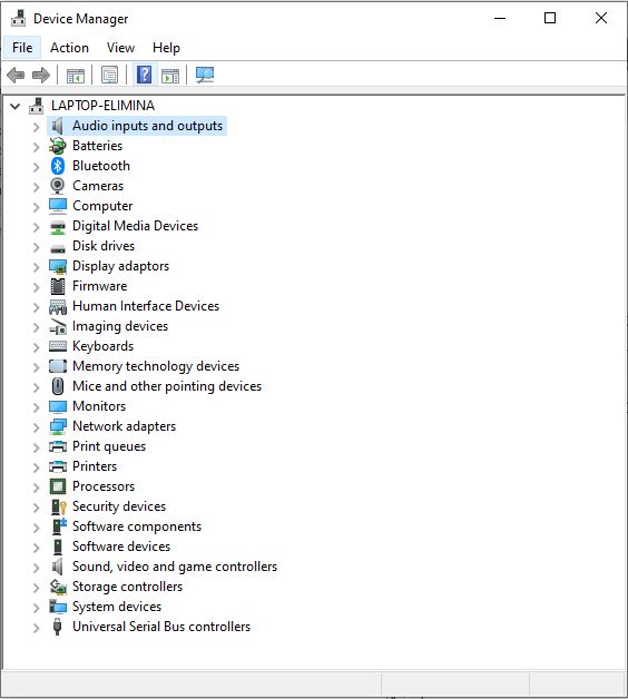

I have found the problematic device in device manager (see screenshot) and tried to get windows to automatically update the driver but it says it has the latest version already.
It doesn't result in a crash and windows seems to recover but it happens a few times per minute.

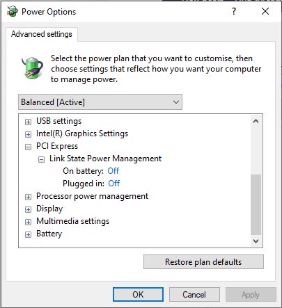

Changing the power saving setting for the PCI express seems to stop the warnings arising. Should I be worried about this and try and fix it, or are the warnings safe to ignore, as they are not actually causing any crashes and changing the PCI express power saving settings seams to resolve the problem?

Annoyingly for some reason my power settings "forget" I have turned PCI Express power savings off and revert back to the problematic setting after I have shut down and restarted. Any idea why that would happen?

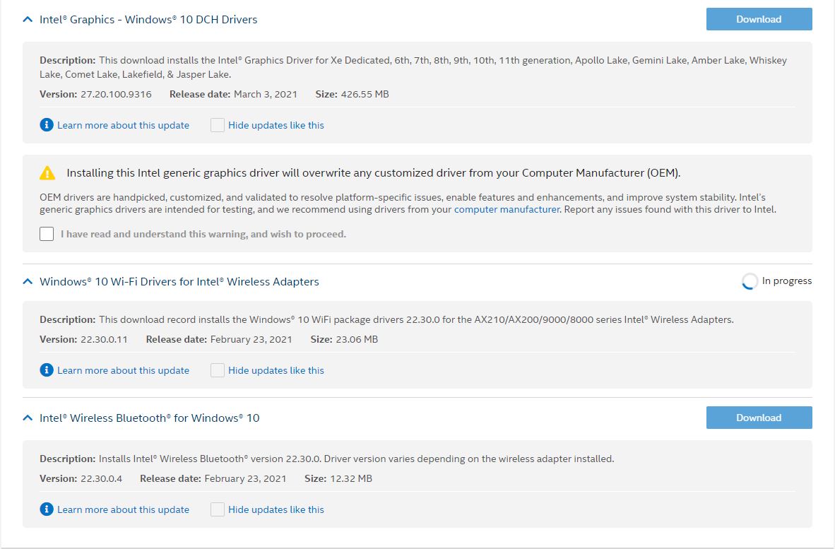

Thanks for the suggestion. There were 3 updates suggested (per screenshot attached). I've installed the WiFi device and bluetooth ones. Updating these two hasn't stopped the event 17 issue.
Unsure about the UHD graphics driver as it mentions it will overwrite the OEM provider graphics driver? Should I go ahead and install that too?

Yes, install them all.
Can you take a screenshot of your device manager?
Style evo
OK all installed. No change in the event 17 behavior. Attached is my device manager screenshot.

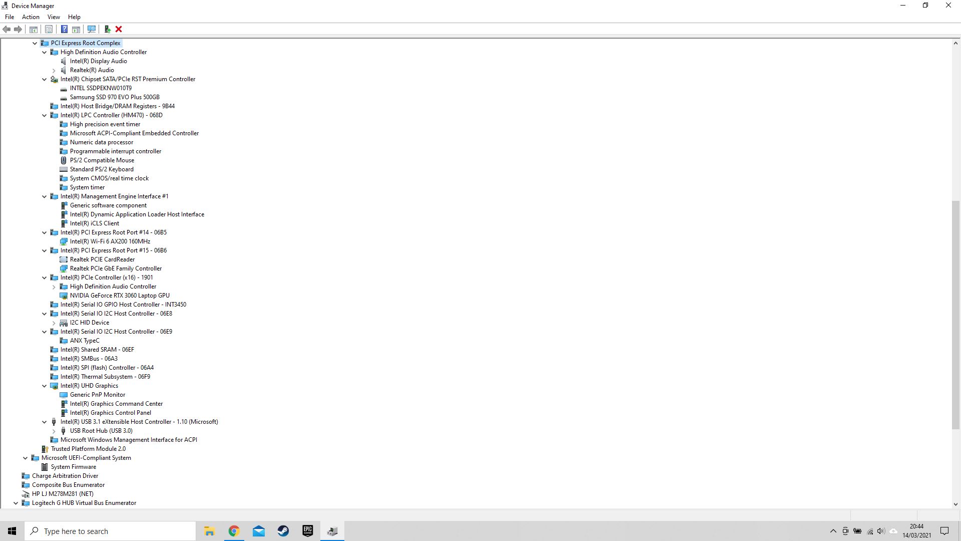

If you go into Device Manager in Windows, then change the view to "by connection type" and shuffle through all the PCI Express Root Port, post what's included in that.
Style evo
Please find attached. The offending Root Port is #15 - 06b6 so perhaps the issue is with either the PCIE Card Reader or the GbE controller? I think the latter is the LAN connector?
Yep, you’re right.
Both Realtek which would make sense.

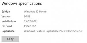

Just before we proceed, which version of windows are you on? Some devices have been shipped missing the H2 update, just wondering if that’s been applied yet?
Style evo
Please see attached - looks like the 2020 H2 version.

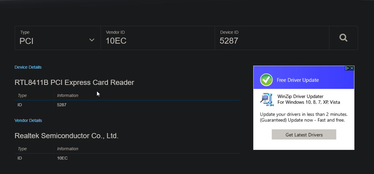

When it comes to hardware ID's like this, there's a site called DeviceHunt where you can enter the vendor ID and device ID and it will tell you the device it relates to: https://devicehunt.com/view/type/pci/vendor/10EC/device/5287
So then we can google the RTL8411b PCI Express Card Reader (it brings up realtek.cz which is NOT the official domain), went to realteks known website and looked for that device under drivers:
That install appears to address both devices, so should sort it hopefully. There's also a very recent update at the end of february. My guess is windows update hasn't got the latest version in the catalogue yet.
