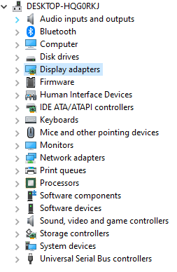

As above, have you checked device manager for any missing devices?

looks like its all there

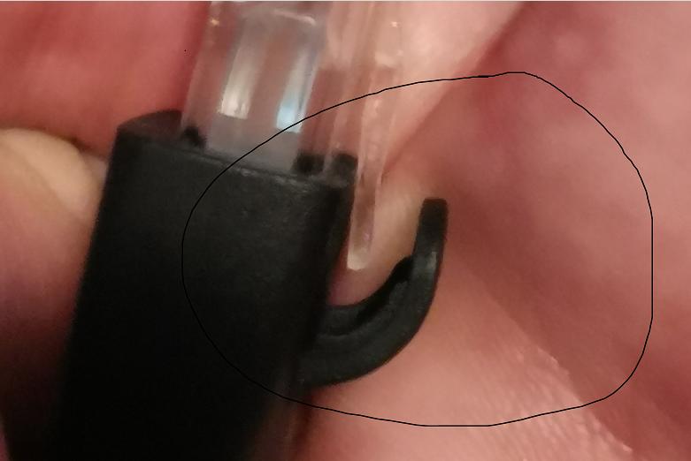

Think I found the issue, when i press the connector in it does not go click, which i think makes it so it doesnt connnect properly
