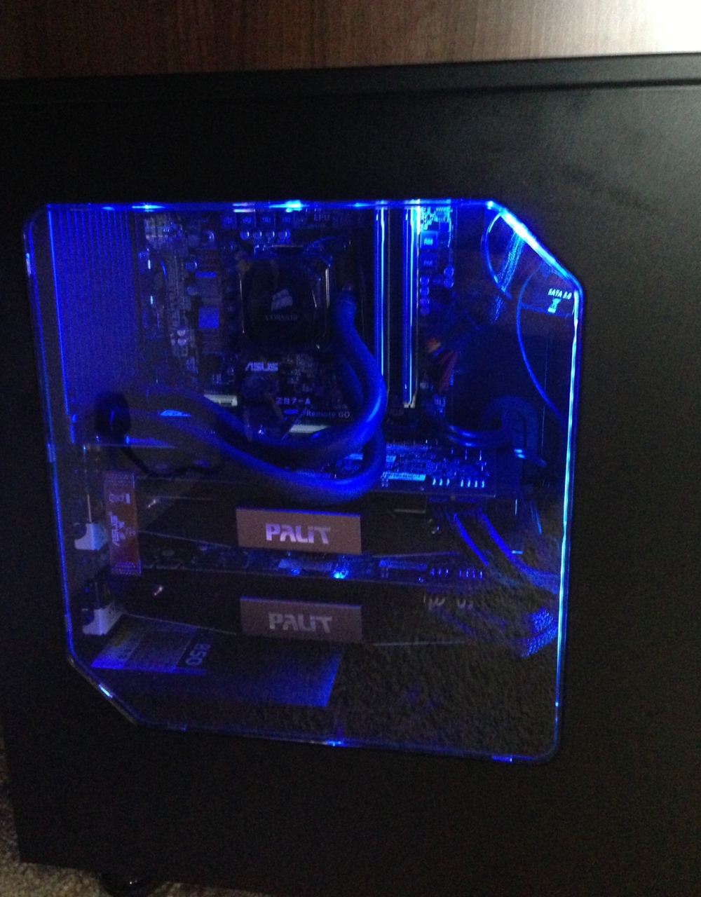

I received some help from members on here with reducing GPU temperatures in my new rig so I thought i'd post a couple of pictures up to show the finished result.
Ive added 4 Bitfenix 140mm Spectre Blue fans att he front/top and a Scythe Slip Stream Slim 120mm Fan at the bottom.
Also added a couple of LED light strips and a window side panel.
Using MSI afterbruner to change the GPU fan profile and with the addded fans I have brought the GPU temps down to a max of 80.
Overall a nice rig but it isn't very quiet. Not much of a problem for me but may be an issue for others that may choose this case.
Lastly I spent a bit of time tidying up the cables behind the desk and PC so it looks much nicer now.

Very nice, that looks great. How are your temps? I was thinking about upgrading my PSU and adding a second 7950 but was concerned about that sort of set up in my R3. I've added a second front intake fan and a top exhaust too, guess I could add a side fan too if needs be.

Using MSI Afterburner I am getting 80 degrees while playing BF3 on ultra. I have also turned adaptive v-sync on which limits the GPU output when over 60fps.
I had the R3 before this with an SLI setup as well. The side fan made the biggest difference so if you go ahead with your plans and see temps that are too high then that would be my first port of call. The R4 is pretty much the same as the R3 except its slightly wider. A really like the look of them.
When the weather cools down the temps will be less of a problem. I wasn't overly impressed PCS shipped my PC with only 2 fans, temps were over 90 on the GPU. But it has been sorted now so i won't go on.
The sound card doesn't have the nice looking cover on it either for some reason, bit of a shame when using a window but no big deal.

Ok thank you. I'll probably sling the side fan in as well then. I hit about 64 max at the moment (during the heat wave) and I'd like to keep things as low as I can obviously. I love the FD R range of cases too, nice to have something that isn't so loud looking. Mine is very quiet as long as I'm not doing graphics stuff too which is a must for me.
I guess all the parts they use are OEM which is why your soundcard looks plain I imagine. The GPU I got originally was the same.
