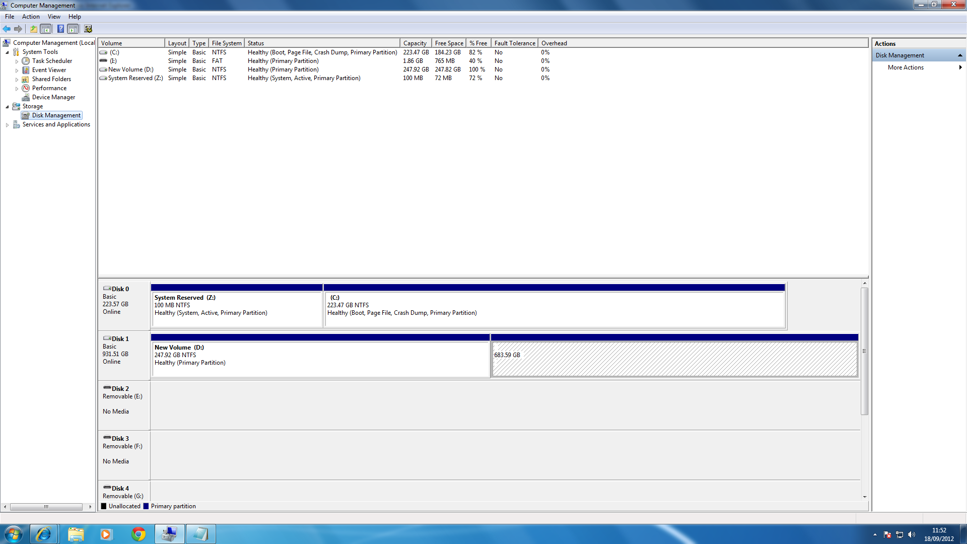

BestUsername
Attached.
Oh yeah btw, hardware literate but software illiterate here - how does one update windows?

Your disk management appears to be ok,apart from the system reserved partition having a drive letter,but you could easily remove the drive letter,and the 683GB
partition not having a drive letter when it should.
