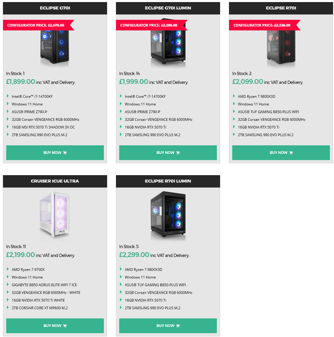

Or, second thought, should I just get a quick-and-easy (and presumably sensibly specced) PCS ready-built? Since customising clearly isn't my forte, and these below look decent!
Get one for a bit lower than £2.5 and just buy myself a nice cake to celebrate with the winnings. 🎂
