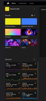

Hello! I recieved my PC about a week ago and although it runs increibdly well there are ferw things that just dont feel right. Maybe I am wrong here and just underestimated the power of these parts but it seems a bit ridiculous. First of all the GPU temps are all over the place depending on the game. Reaching 75° on average with a hotspot on the GPU that tends to be about 20° higher. For clarirication I game at 1440p with settingd pretty much maxed
The CPU (I understand its an i9 14900k it is a monster to cool) I have underclocked it and it doesnt tend to really ever go above 75° which honestly is fine I dont have too many problems with that. But one thing that is really annoying that i cantr seem to fix no matter the fan curves is the noise of the PC while playing rpetty much anything. After playing for any game for 15 or so minutes the coolant has reached beetween 40/42° and the AIO fan is insanely loud. Yes I do try and ignore it with my headphones but it seems excessive and I cant really find people online complaining about the AIO fans themselves. Most complaints are about the pump I seem to be having no issues on that end. Any guidance or support would be greatly appreciated I just need to know if I am going crazy or if this is just how its meant to be

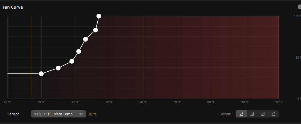

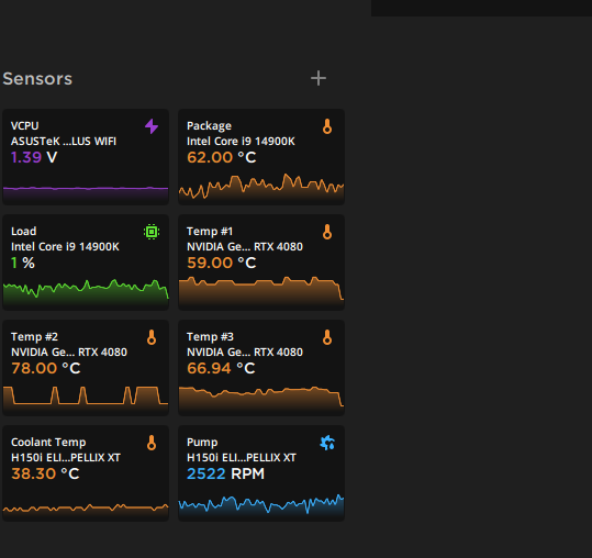

That's very healthy, the target temp is 84 so anything under that is a bonus. And I believe the ceiling for the hotspot is roughly 110c under stress test, I'm not saying you'd want to see those temps under a gaming load, but they're accounted for by the design.
What are you using to set the fan curves, and what profile to you have set on the pump?

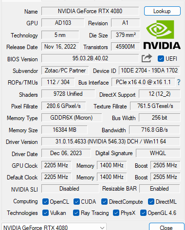

Can you confirm the exact GPU model? You can see this using GPU-z and use the Lookup button: https://www.techpowerup.com/gpuz/
From Corsairs comments here, 35 - 45c under load is the "normal" expected range depending on processor with 60c being where you need to start being concerned, and the 14900k is one of the hottest processors on the planet, so the coolant temp doesn't seem bad at all.
Oh well that is definitely nice to hear atleast. The Target temp usuallty maxes out at 75 so thats nice to hear. The hotspot being almost 20 stometimes 25 higher though felt concerning even though by design its accounted for.
I have updated my post with all of this information. but iCUE is dealing with all of this.
I have posted a screenshot for this! All I know is it an OEM card.

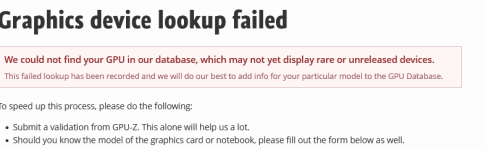

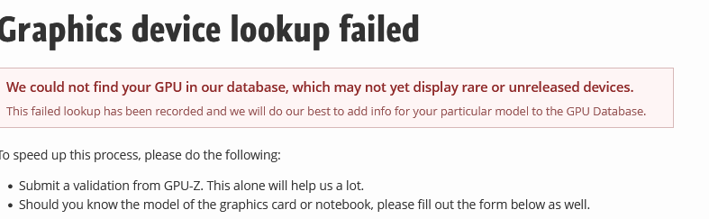

You haven't posted the card make and model? You need to use the lookup button
When I press look up it says Graphic device lookup failed. I have included a screenshot now
And if you set the default fan curve as well for testing? And the pump profile on Balanced.
None of the other fans have a custom curve set they are all just defaulted to quiet. Or balanced in the Pumps case which are all just default presets., I have set everythig to balanced and started agame to show you what the fans would look like. This is very loud though

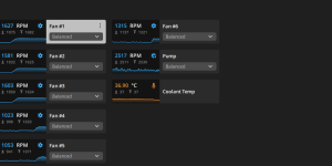

I think your fan curves are just far too aggressive and too high RPM

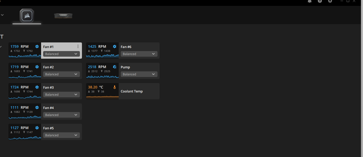

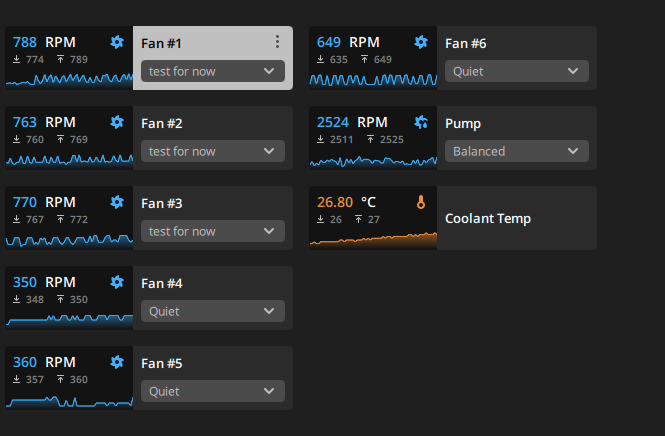

I have tested for about 25 minutes. Admittedly with everything on balanced my temps are way better atleats in the CPU's case. BUT the computer is way too loud now its like a wind turbine
And what's making the noise, it can't be the radiator fans? Or is it still running your fan curve?
If you can post the fan speeds from icue also?
I posted the iCUE fan speeds didnt I? Sorry if I am misunderstanding is that not incldued in one of the images I attached? I mean the case fans are deinfitely part of the sound now being almost 1400RPM on the back fan 1150 respectively on the front fans. The AIO fans are all 1750 though. I am not running any custom fan curve during this testing no. As you can see its all balanced whis is one of the default options
After this testing. I changed the AIO from balanced to quiet and sound wise difference between 1300rpm and 1100 rpm is huge. I wish could attach a video showing you the AIO fans on quiet and the AIO fans on extreme so you can hear the difference
Sorry, I'm blind, ignore me, seen them now.
The cooler fans on balanced mode should be more near the 1200rpm range, nowhere near 1700rpm, so there's something strange going on there, suggests it's not actually using the default fan curve.

I'm not seeing the issue in numbers as such.
