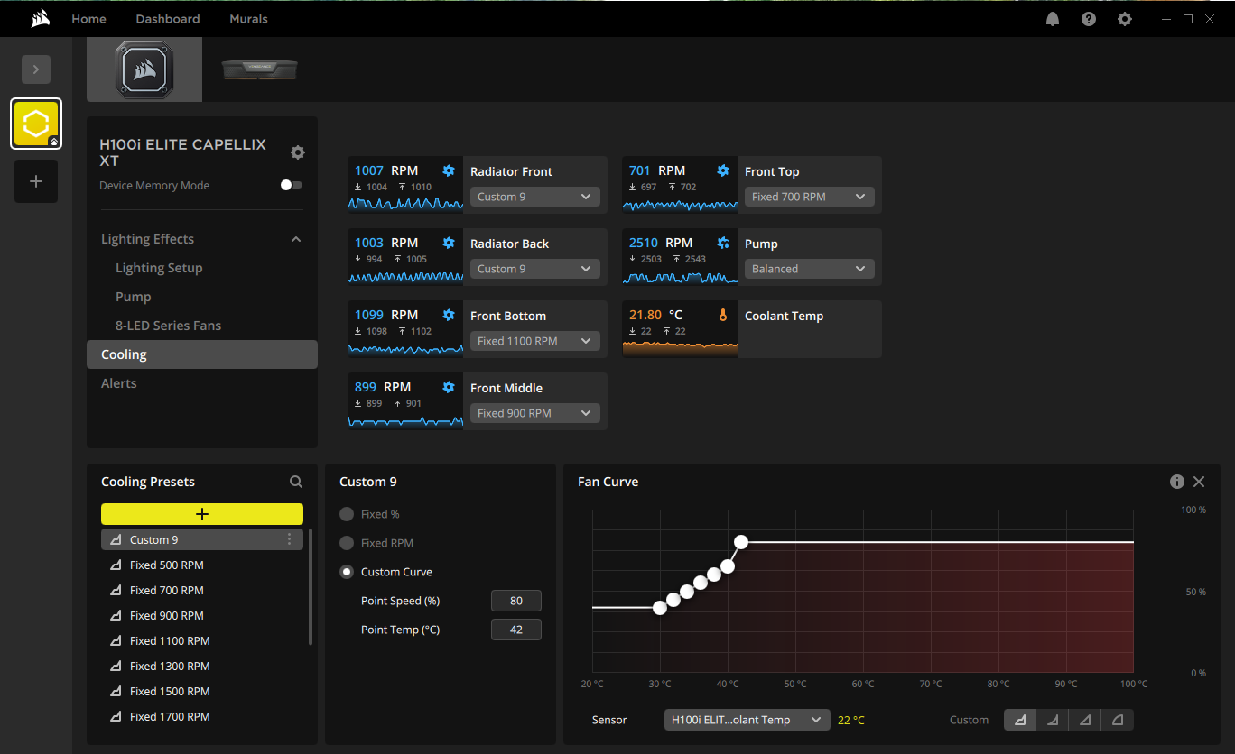

For the Corsair cooler, best to set the pump on balanced as quiet will run too slow for efficient flow. The other fans can either be on a static speed or a gradual rise as the coolant temp rises. My cooler and bottom* fans ramp up by about 100rpm per 1ºc over 30ºc, from a base of 800rpm.
* I have a 6500X case, so have side & bottom fans - side ones are low speed and silent for a constant pressure.
DrYFronts
Using your curve for the radiator fans, here's how mine looks. Should I do the same with the case fans?

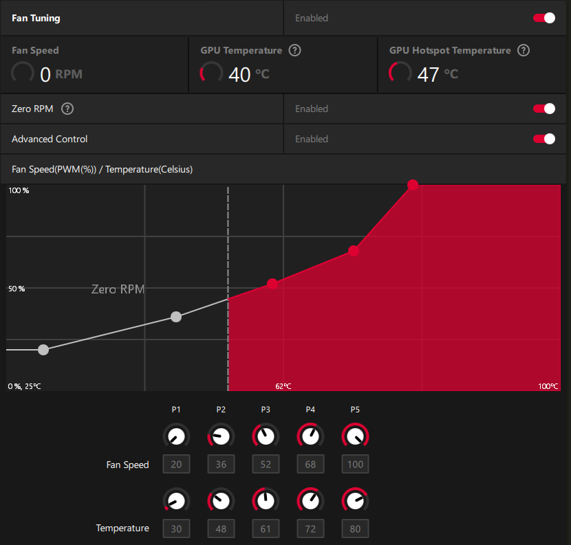

Any ideas for the GPU curve? Below is the base setting.
DrYFronts
Tested it again with this newfound knowledge. The case/rad fans are behaving, but the GPU ramped up. I disabled Zero RPM in Adrenalin and tried again and they were much quieter. I think it's safe to say the GPU fans were the culprits.
Glad you sorted the GPU fans out, as I've no experience of AMD GPUs or Adrenaline software, so would have been no use.
As for the iCUE fan profiles, yes that's similar to what mine looks like...and as you've found out there are not enough points to plot 1ºc curves, so it just has to be 2-3ºc per 200-300rpm increase.
