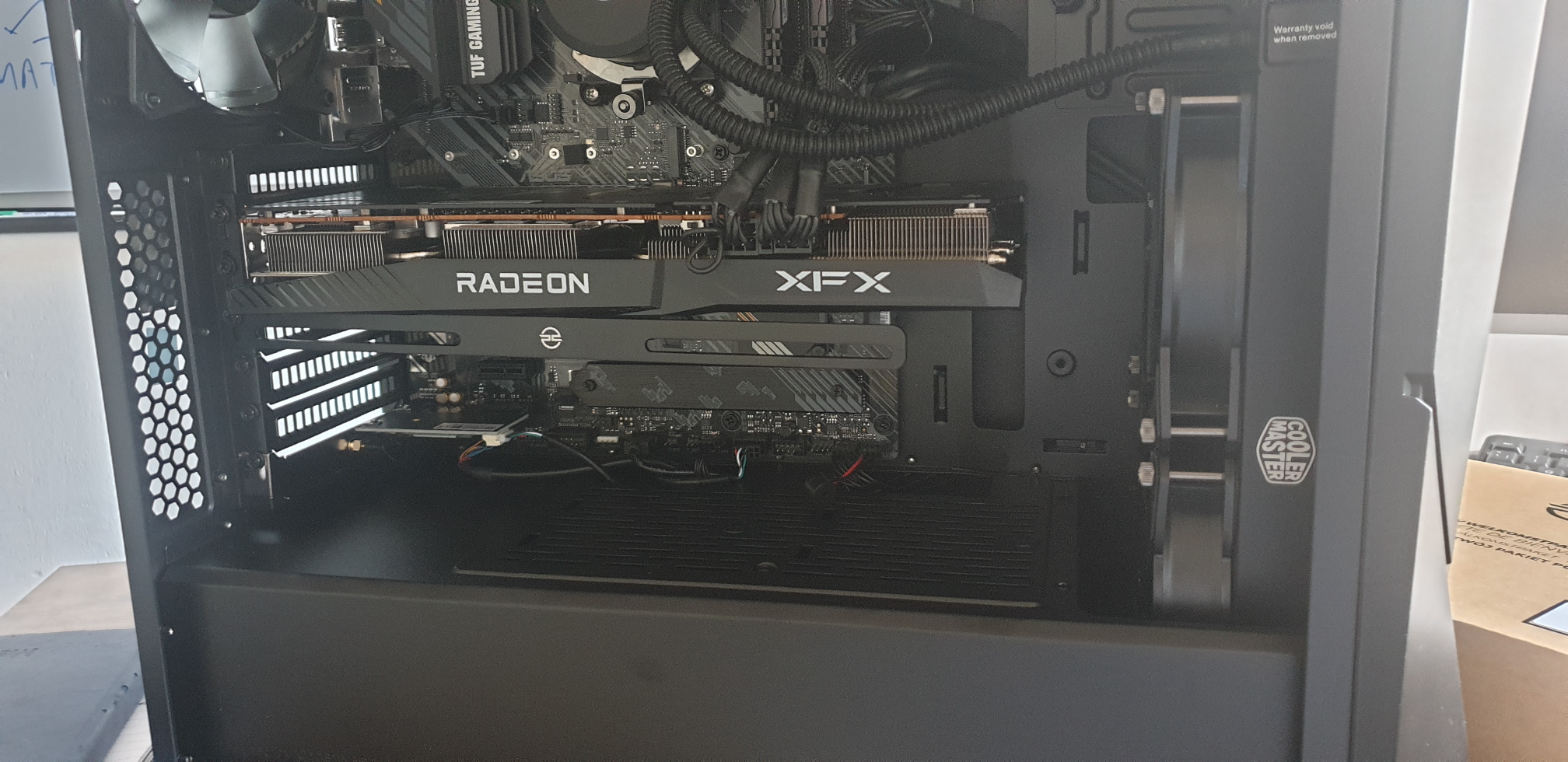

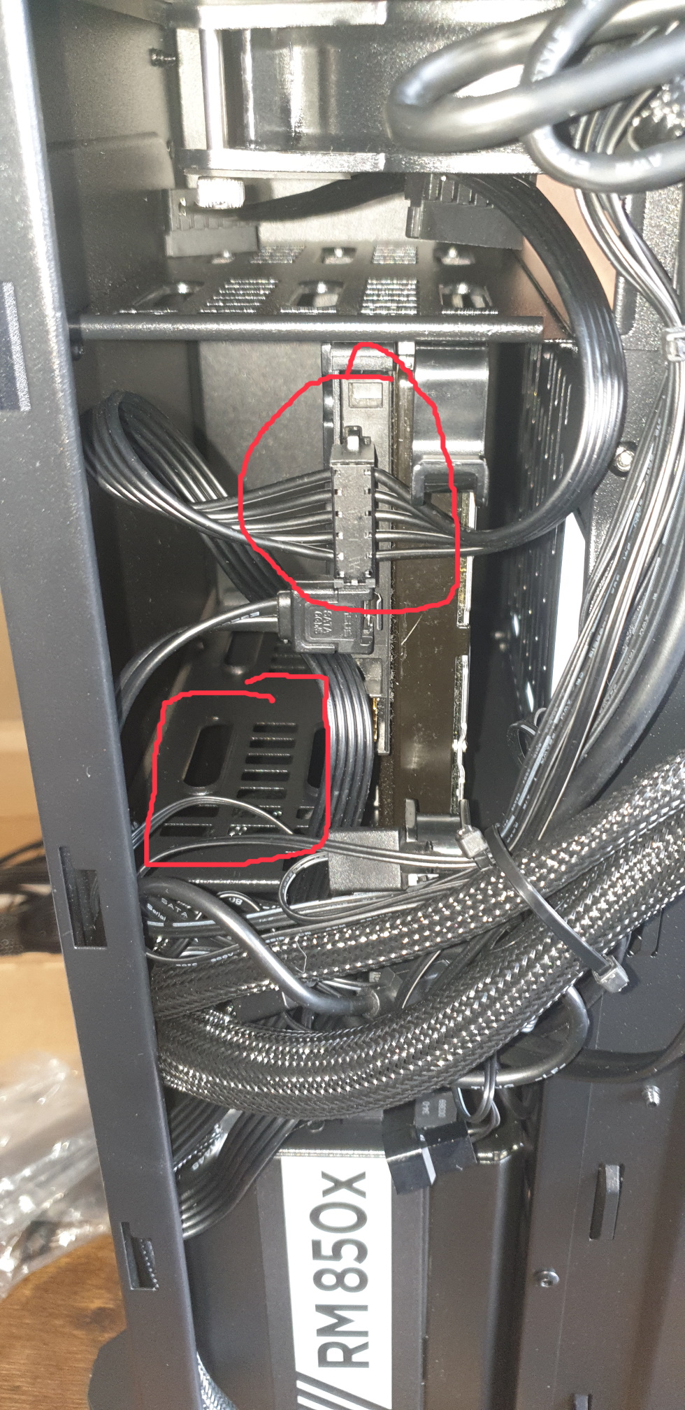

Hi All
So my new desktop arrived today - which was great and extremely quick.
However, adding my 2TB HDD seems a lot more complicated than I recall (not something ive done for over a decade or more).
I've found where they slot in after removing the opposite side panel - but I'm not sure how to get the power cable to the power unit (which seems closed off and impossible to get to).
Its a COOLERMASTER MASTERBOX K500 ARGB GAMING CASE if that helps

Zelios
Thanks thats helped - have managed to take the power unit out and plug the cable in. Just need to work out how to get into BIOS and get it to recognise the HDD now - tried del and F12 as its booting up - has that changed in the last 15 years? :)
You don't need to access the BIOS at all to recognise a secondary drive. It will be automatically recognised.
Its from my old PC so still has some of my stuff on it - Game Mods etc
In that case if it's correctly connected it will just show up in windows. You don't need to do anything to it.
You mentioned connecting up the PSU SATA Power, have you made sure the SATA Data cable is connected to the motherboard? Sorry if it sounds redundant.
