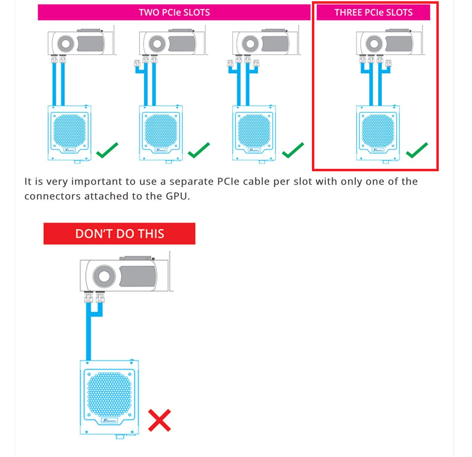

sorry for jumping in, I looked at the last image and it seems you only have one PCIE cable going to the GPU witch is split, it should have 2 PCIE cables going in to the 12 pin splitter like the image below, that may help the one with the red box around it is for 3 cables, so you can ignore that but look at the 2 PCIE slot images. Hope this helps

Oh interesting! So if I'm using the 3080 FE 12 pin adapter, it would be two separate PCIE cables, one for each 8 pin? I will try this!
ChaLow
So I've got the other PCIE cable connected to the power supply, but this one won't go into the 3080 FE 12 pin adapter. It's like it fits, but won't push in. Also this cable has PCIE 4 written on the input end, instead of the PSU output like the other one.. Do I push harder or have I got something wrong?
