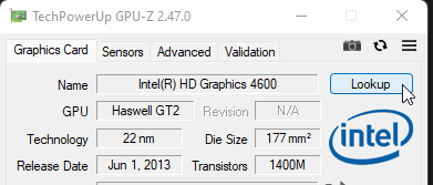

@Logicdon if you could let us know the make and model of the GPU, you can find this out with GPU z

Zotac/PC Partner@Logicdon if you could let us know the make and model of the GPU, you can find this out with GPU z
TechPowerUp
GPU-Z is a lightweight system utility designed to provide vital information about your video card and graphics processor.www.techpowerup.com
If you click the lookup button in the top right?Zotac/PC Partner
Device ID: 10DE 2489-19DA 1630
Is this the info you need?
