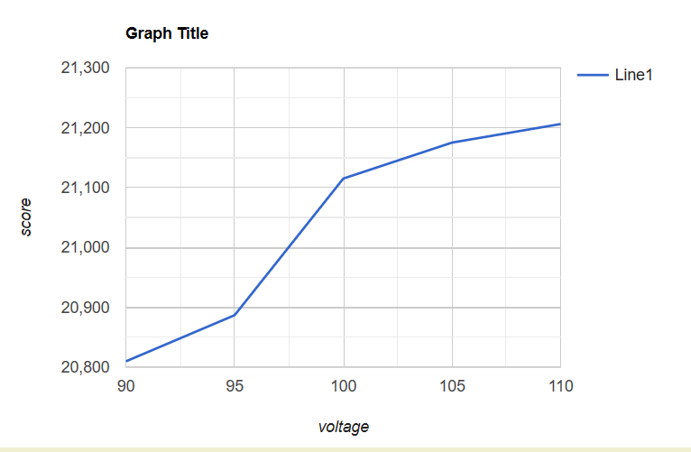

Firestrike score with a -100mv undervolt on the cpu
attached is a graph of some tests I was doing with XTU open so I could monitor the throttling which knocked a few hundred off the score when XTU was on so the values are a little bit lower than my high score.
-100mv seems to be the sweet spot
