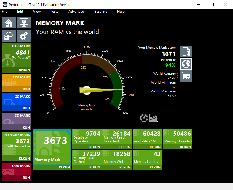

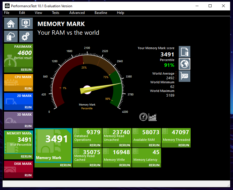

For anyone interested, my Corsair Vengeance Pro RGB 3200MHz 64GB kit (CL16-18-18-36) now runs at a comfortable 3400MHz with CL16-16-17-36 timings. This has seen notable benchmark improvements:
Baseline, stock D.O.C.P:
After OC'ing:
Voltage was increased slightly from 1.350v to 1.375v. Temperatures are slightly raised, which I'm still trying to learn more about. Corsair themselves state that this is fine, with no issues until much closer to 80+ degrees. Other (older) forum posts suggest RAM can have issues at 50 degrees, including corruption.
Stock was ~ 40 degrees c, increasing to 5 degrees c under load.
OC is now hovering ~ 47 degrees c, increasing up to a maximum of 62 degrees c under load, but more commonly ~ 60.

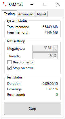

A 9 hour RAM stress test returns no errors too, which makes me happy!

Is that Ram Test by Karhu? If yer bored - we’d recommend MemTest86 as the most thorough stability test. It’ll take a similar length of time to the above so you could leave it run overnight....

Yeah that's Karhu, I read a few different posts regarding memory stress testers. Older posts, admittedly, stating that MemTest86 was not as likely to identify errors compared to Karhu? As you've said though, if it gets left to run over night it won't do any harm to run that too, and it's free!
