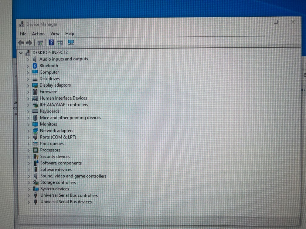

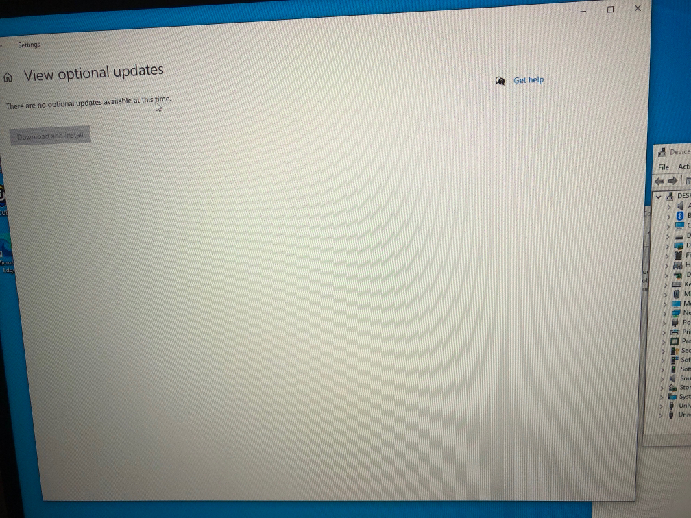

Hi both,
I have attached the photos requested. Please let me know if there is anything else, or if you want better images.
Thanks.
Ok can you connect it via Ethernet to install those updates it mentions, I reckon be a chipset or other driver amongst them related to Wi-Fi
