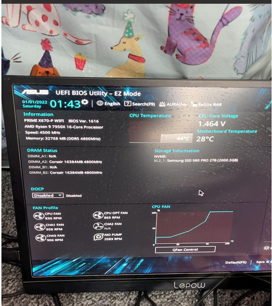

When i came back after 30mins, I powered it on and my heart stopped when i saw the ASUS logo on the screen !!!!!!
I could see the message that BIOS was reset (i entered the bios and could see the clock was set to 2022). I did a CTRL-ALT-DEL and the system restarted and booted in to Win10 !!! - all my files etc were intact.

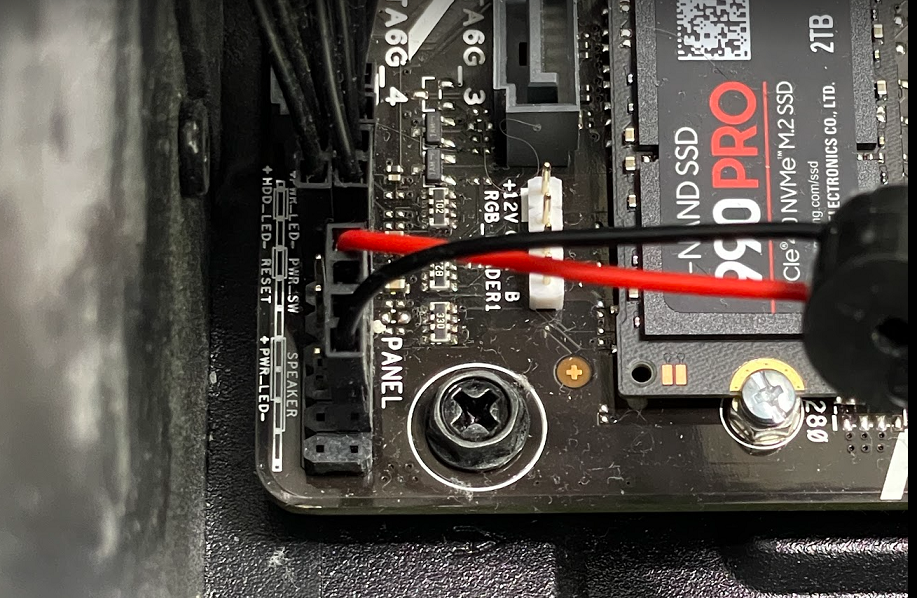

If you haven't ever heard beeps then it's possible there is no speaker. Is there any LED lighting on the motherboard to indicate POST status?
Having a look at the pic I can see the little speaker attached down the bottom left (on the pic). This should be giving you a beep upon posting.

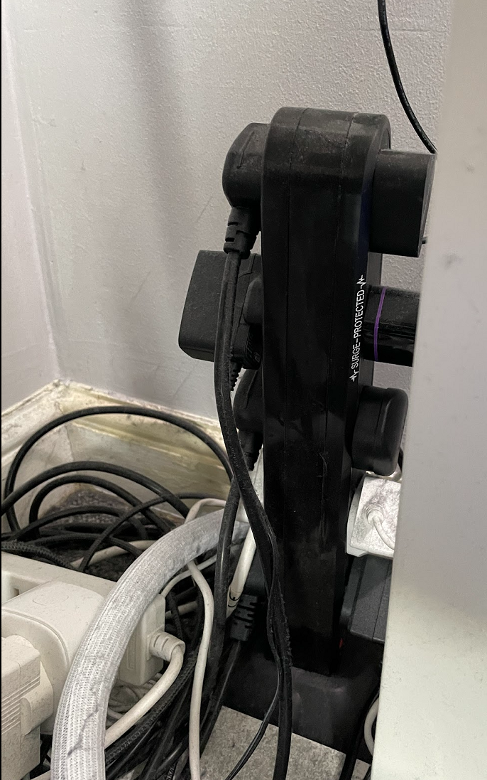

Make sure that PCS/Curry's know that the PC was plugged into a surge protector. Had you not done so you might have voided the warranty. 😉

Does this speak look like its plugged in properly:
Anything else to try or is it time for RMA ?

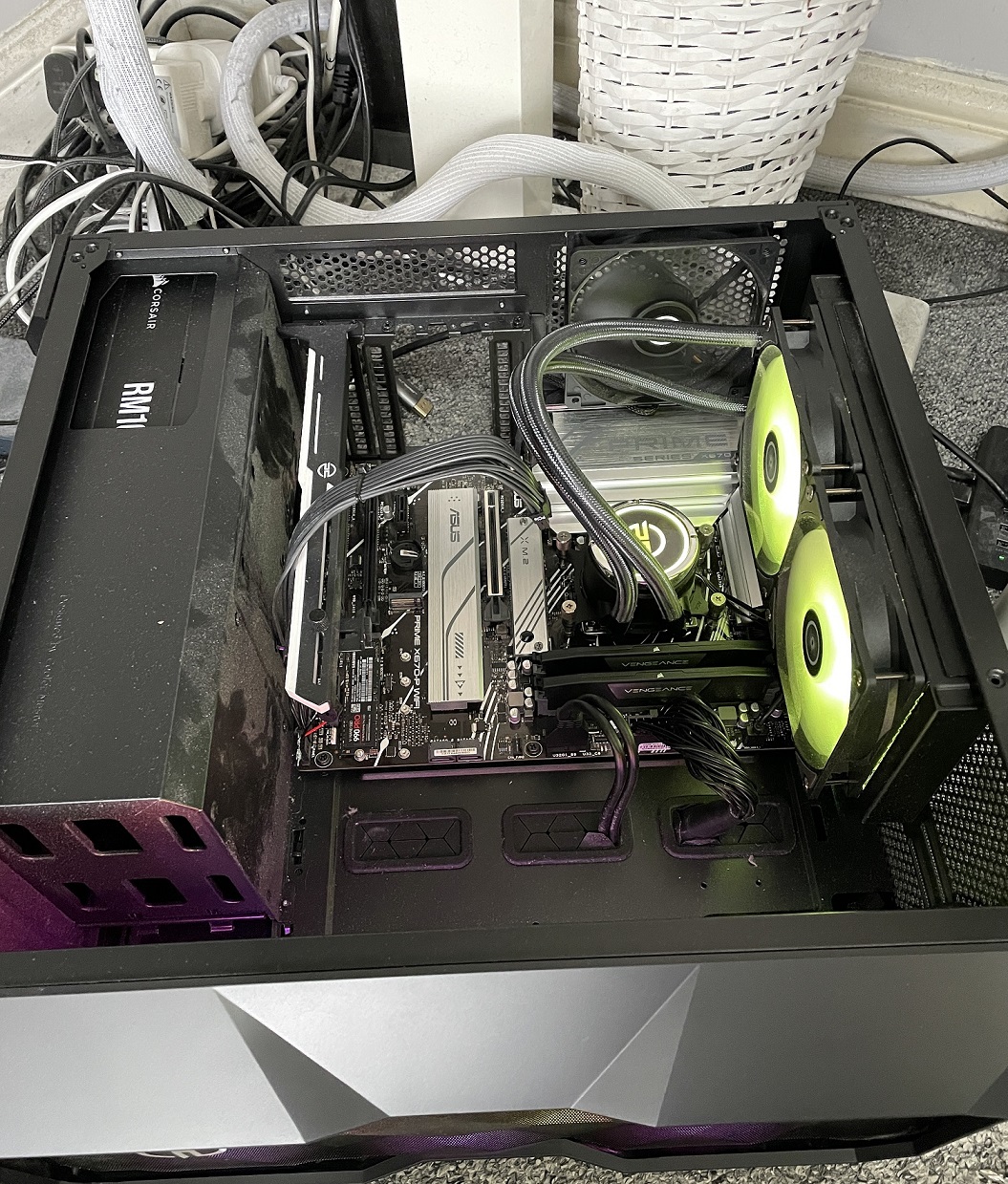

Is there an easy way to get to the PSU connections ? I did the the other side panel off but I cant see (easily) where the cables are going in to the PSU.
Everything is bound, really tightly, with wire tidy clips !!!

I put everything back in and for the sheer lols, i try and power it on .............. i get display on my 1080p monitor ! - same bios warning as before.
I reboot the PC to see if its going to keep working and unfortunately i get the same no-display issue.
I then think that it could be my 4090 (maybe it cant get enough power due to the surge or something or maybe its just fried 😲), So i just unplug the power to the card and restart the PC.
The PC boots again to bios !!!
This time I go to the bios and think maybe I need to make a change (to ensure that I can write changes, after changing the CMOS battery), So i change a random setting (boot up logo size!). I save changes and reboot.
Again the PC boots to bios and I confirm my change was saved.
