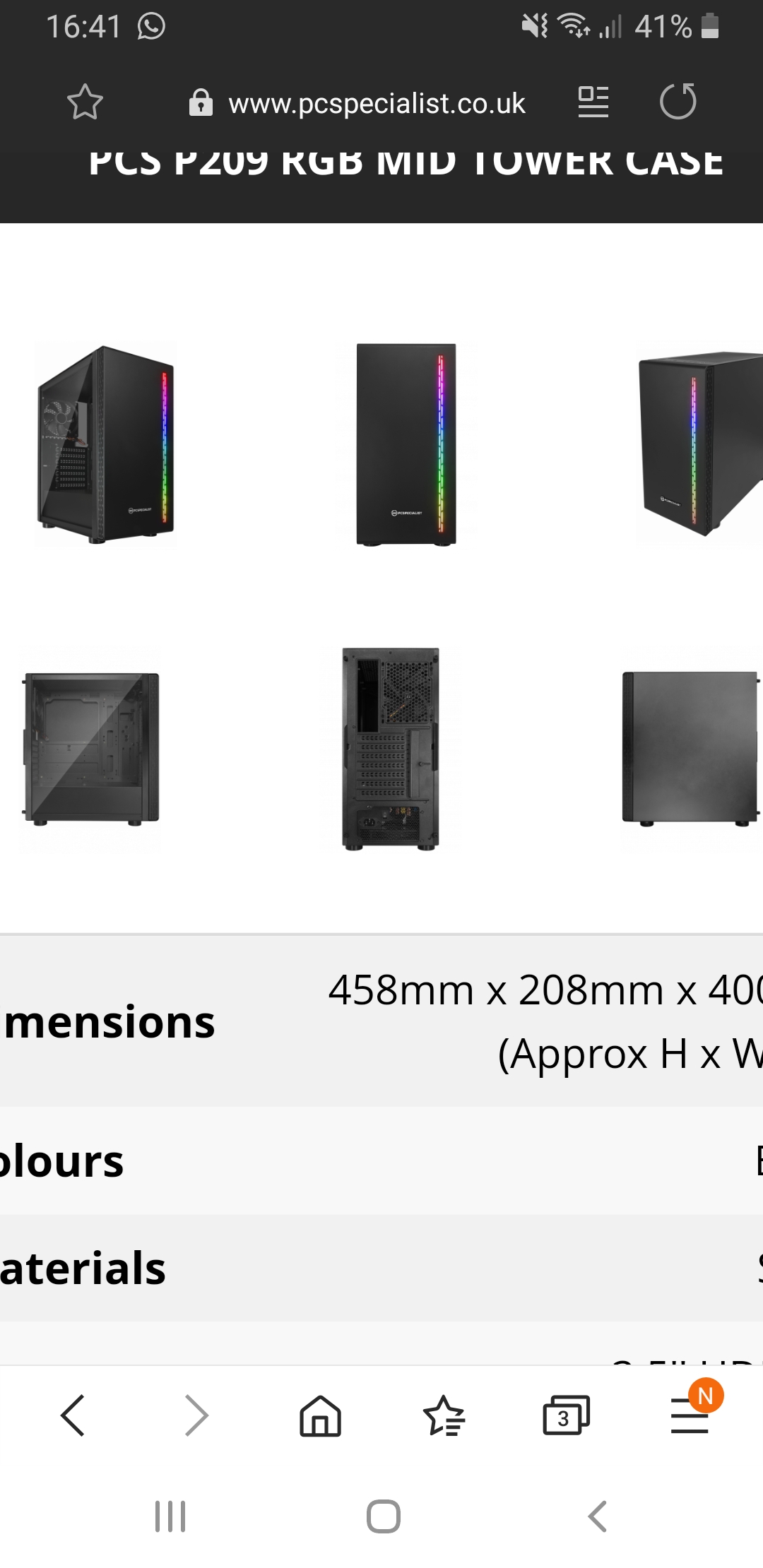

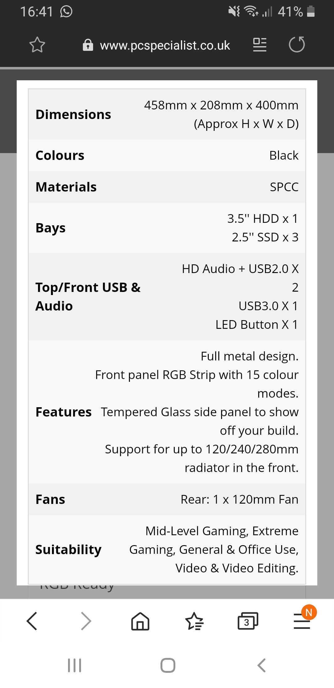

I bought a custom build from pcs in January (loving it everything works smoothly) only issue is I hadn't done enough research. Being new to pc gaming and custom building I chose a case with a solid front panel the PCS P209 mid tower case. I added two more exhaust fans the the roof of the case so now I 3 exhaust fans in total and no intake fans so everything's running a little hot. Not too hot its damaging I'm more concerned about the negative pressure and dust build up. I was just wondering having the solid front panel, would fitting front intake fans be pointless and if it's worth doing is it possible to fit a dust filter on there too. Or maybe just replace the front panel for a mesh one instead if that's possible. I only just got the pc I dont want to have to transfer it to a brand new case and risk breaking anything. This is the case and the specs for it from the website.

If anyone can help me out I'd be very grateful thank you.

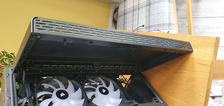

I have this case for my build. the front panel has side vents which let in airflow. i have fitted two fans to the top as well as two intake fans to the front. easy to do, and ive noticed reasonable temps too. cpu around 50c gaming with the GPU reaching about 70-75.
