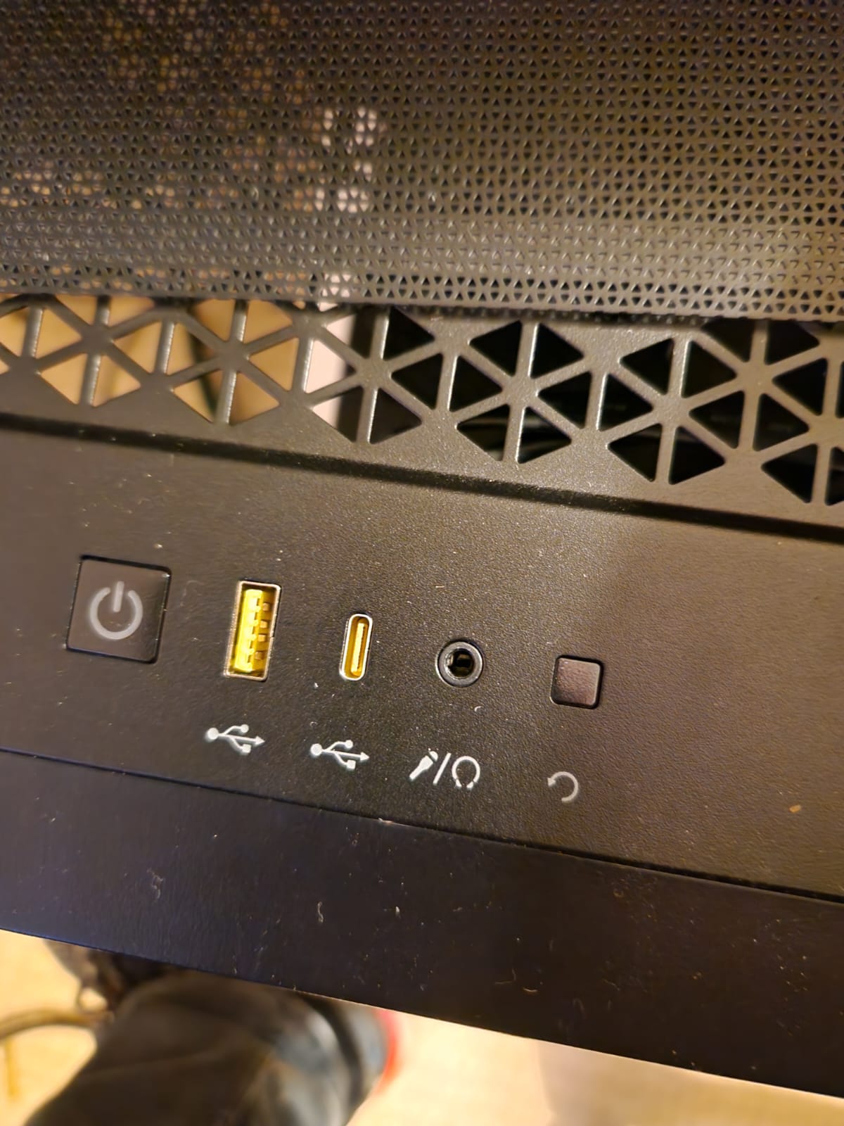

I have a desktop with a CORSAIR 4000D case. There are two USB ports on the top front - one of which is USC-C. Theis USB-C port is not working in that any drive plugged in there there .shows up on the Windows Explorer. Does any one have any suggestions on how to check for any faults or even resolve it?

PS - the USB-C plug is very loose in the socket so could this be the reason? (the USB is also yellow coloured on the inside, whatever this means)

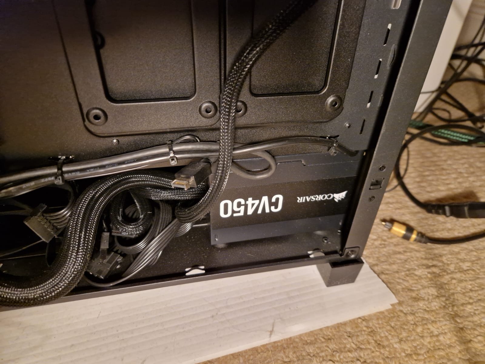

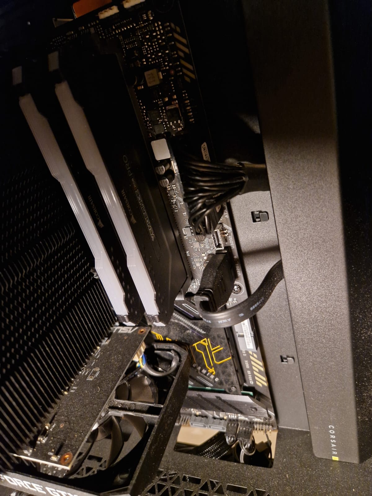

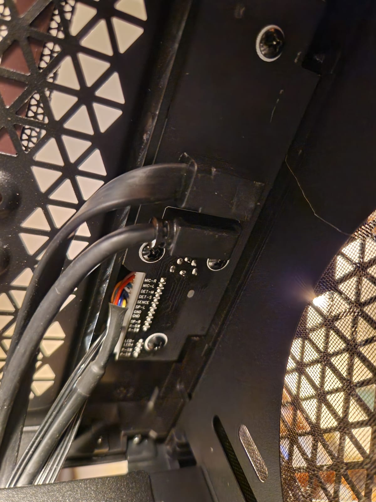

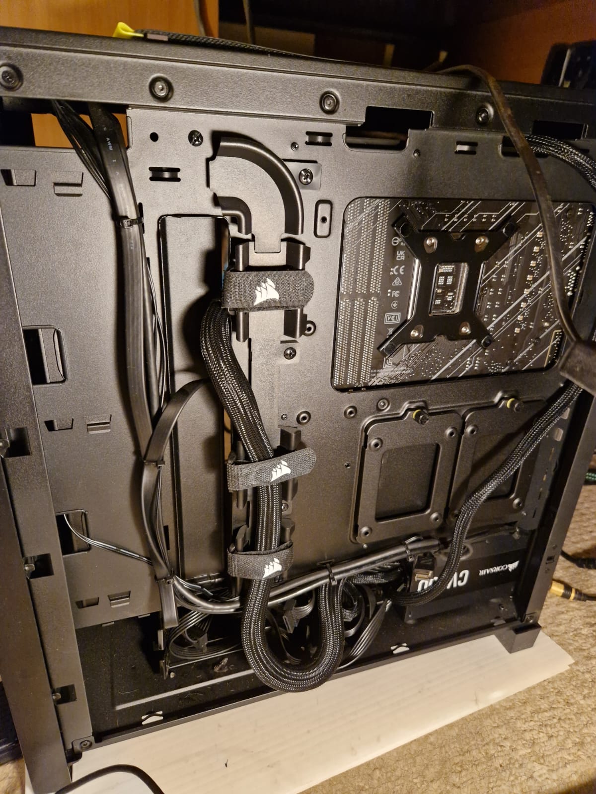

I have attached some photos: one showing the ports on the top of the casing, one of the plugs underneath on the inside of the casing (they line up with the USB, not with the power switch), a picture of the right hand panel inside showing the track of the cables, a close-up of the end of the USB-C cable end and a close-up of the USB-A attached to the motherboard. All plugs as they are are firmly seated
So there are the three cables coming from inside the top panel of the case:
- A flat cable, goes out to the right, halfway down the right hand panel then loops back into the left hand side and attaches to the motherboard (socket U32G1_78)
- A round cable that comes from the USB-C socket down the right hand side and terminates in a loose plug seen in the close-up
- A second round cable that comes from the panel of pins and dives under the motherboard to a block in a separate cage.
It puzzles me that the USB-C cable is not attached to anything but I still got that 'not enough power' warning - unless a basic power supply is there but cannot do much else.
Next to where the USB-A connects to the mother board is a socket labelled 'U32G2_9'. Is this where the USB-C should be?
Looking at the motherboard specs on the ASUS website, it includes "front USB 3.2 Gen 2 Type C" so I am guessing the port should be supported.
My guess is that the USB C was dislodged when the motherboard when the internal protective packaging was removed.
The not enough power is down to the cable, it's just saying there's not enough power, or none in this instance.
A USB C motherboard header is it's own connector, won't fit in any other port. You just need to plug that back in. If it fits that U32G2_9 port them yes that would be it.
And BINGO! There we have it - all working now. Thank you so much for your help.
The frustrating thing is that the USB cable was cable-tied in with the other round cable - so it was not that the plug had fallen out but that it was not connected in the first place.
