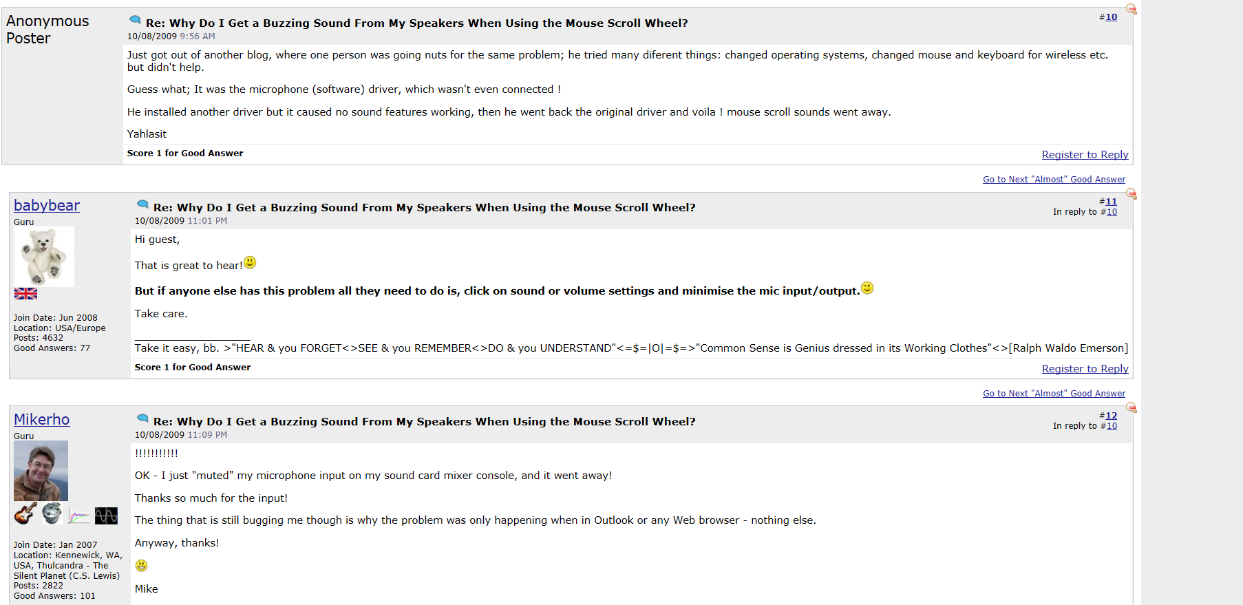

This one seems to have found a solution:
