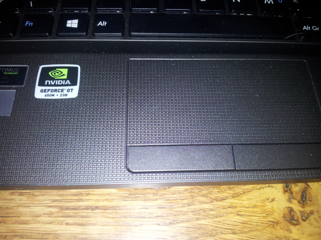

Trackpad
The trackpad has a somewhat rough finish - the same finish as the screen-back and keyboard-surround, in fact. I'm used to a smooth trackpad and found this one to be a bit sticky at first. Again, though, I've been using it this morning without noticing it so I would say it's fine.

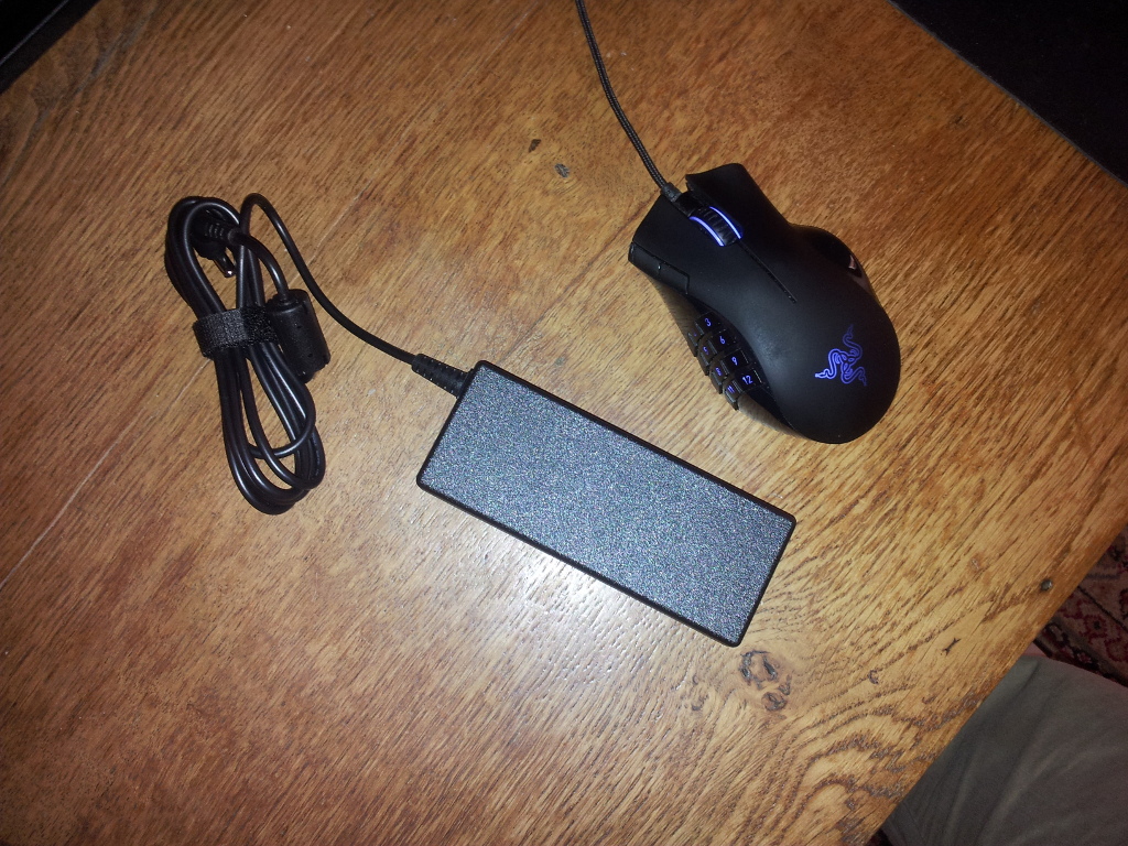

90W Power Adaptor
As mentioned, the use of a 35W CPU allows you to choose a 90W power adaptor. That was my preference because I intend to use this machine while travelling and the idea of a small, light laptop with a large power-brick didn't appeal. I'm pleased to say that the 90W adaptor really isn't that big. It's not the dinky little thing you get with a real netbook, but it's not a monster either and doesn't compromise the light and portable characteristics of the laptop.

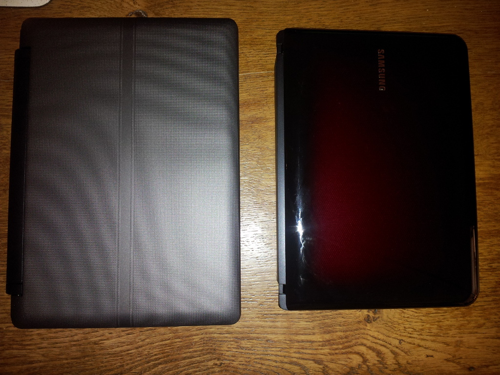

I chose the Inferno over similarly priced laptops because it sounded interesting, characterful and ever so slightly insane: an i7 CPU and a decent GPU in a netbook etc. In reality, it's actually a lot better than that. It doesn't really look like a netbook and in use it doesn't feel like one. It's highly mobile - I carried it everywhere with me yesterday and worked on this review in odd minutes here and there - and it's seriously powerful - you can install a whole Steam library on it and know that you have the CPU and GPU to play any current game. Putting those qualities together, it's a very nice small computer indeed.
The Inferno next to a real netbook. As different as night and day.
