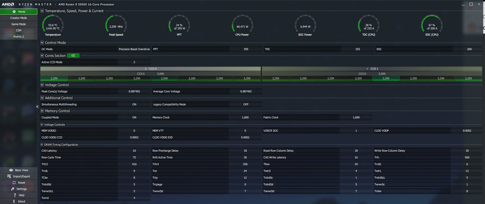

My PPT value shows 395, TDC shows 255 - guess that answers that! Coolant temp 33 degrees.
NoddyPirate
Auto OC mode has been engaged somehow. Go to Creator mode and select default at the top - and then Apply and Test at the bottom - it may want to reboot you system - if it does wait for RM to restart and check the numbers again.......
It's drawing 185 Watts (47% of 395 - which is the motherboard limit) which still isn't all that much to be honest, so I'm still worried about the paste job. But anyway do the above and repost again with the new numbers!

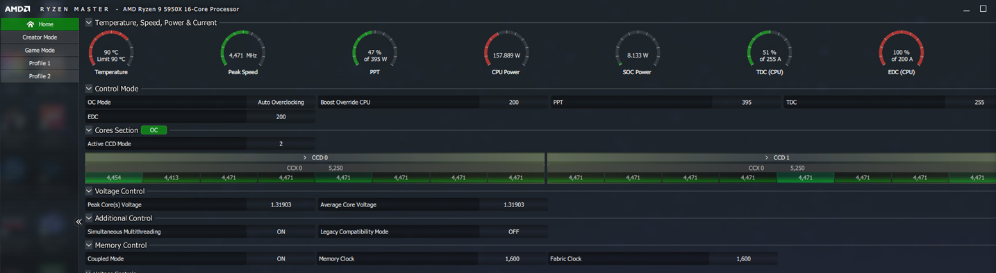

I've disabled everything OC / PBO related in the bios, and the temps now look better. Interestingly enough, the CPU temps were sat at around 80-85c at 4600MHz, and then it backed down to below stock, per the screenshot below:
I'm not sure why it would reduce the clock speed with the Prime 95 test still running, but hey. Coolant temps went up by 1 degree over the course of 15 minutes, to 35c. I'm hopeful that once the root cause has been determined, I can re-enable PBO2, as this is a nice feature AMD promote themselves and is a selling point of the chip.
NoddyPirate
Damn, PBO set to disabled, but undervolting left on. Will have another crack after work 👍
Super. Yes go back in - enable PBO and disable the undervolt first - then return PBO to auto and it should be back to full stock operation.

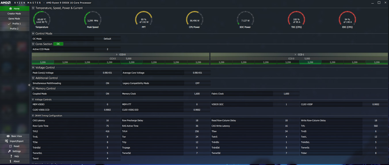

I've re-run a benchmark with Cinebench R23, and with PBO enabled (but the frequency not going over stock) the temps look far better:
I guess one of the next steps is to try a single core benchmark run, rather than multi-core, and see if I can get PBO to behave. Interestingly I can see multiple references to PBO within different areas of the Asus bios. There may be another question incoming!
Does this rule out a bad thermal paste job?

Hmmmm - so there is still something wrong with your settings I think. You are only drawing 95 W there and you should sustaining more like 3.9 GHz all core rather than just the base clock speeds.
Give me two seconds to have a poke around my own system here and let me get back to you.......

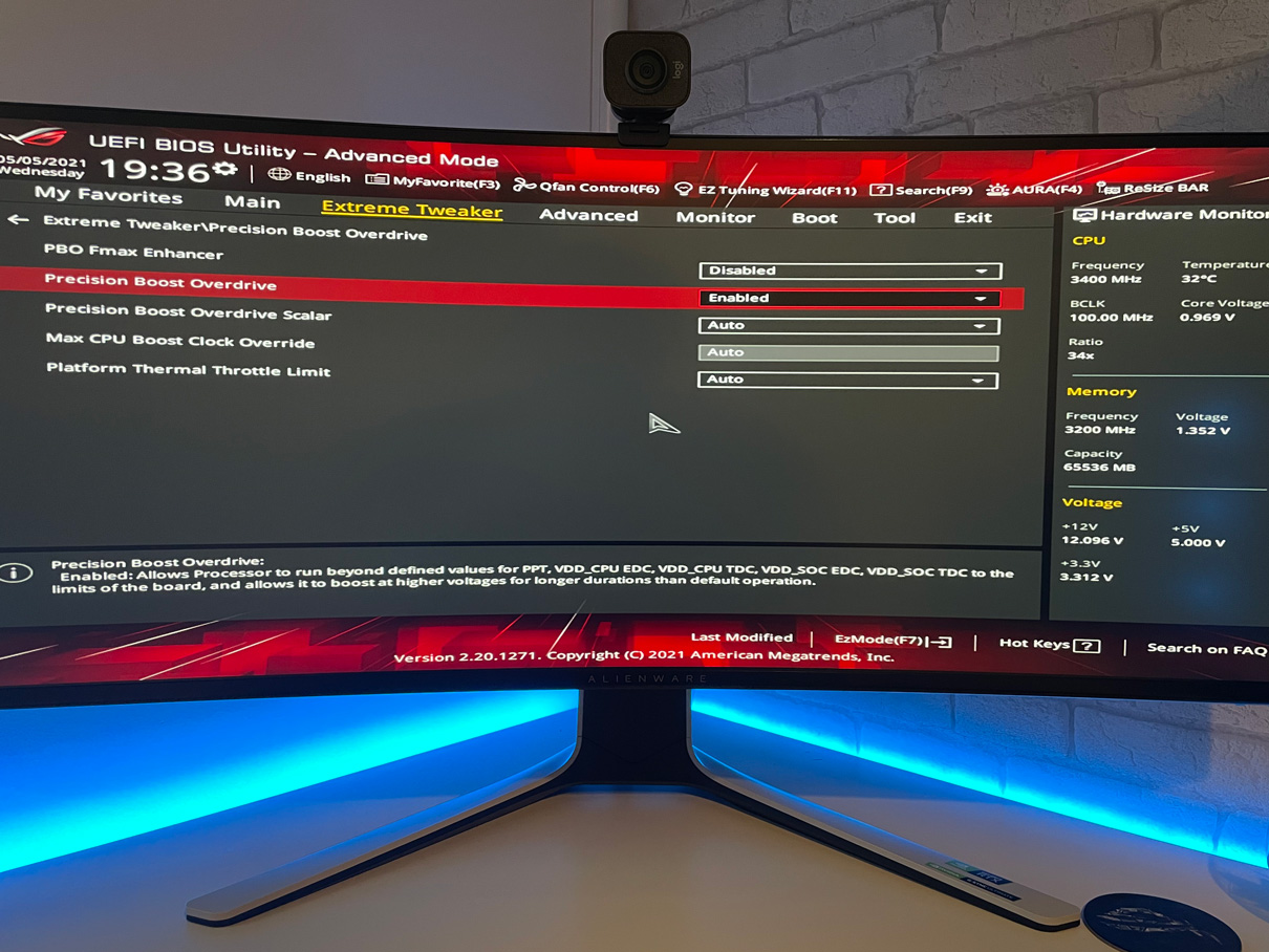

@mossmotorsport - Would you make sure you have set your PBO options - one in AI Tweaker most likely - and the other in AMD Overclocking - to AUTO and not enabled?
If so then select the default profile in RM again and apply it - and reboot your system. It still shows as in PBO mode on your screenshot - so we need to get that back to showing default.
I can't find any PBO setting that would limit you to the base clock of 3.4 GHz - unless something else in BIOS was changed like the BCLK or core ratios and so on - I assume you haven't changed any of those settings? :unsure:

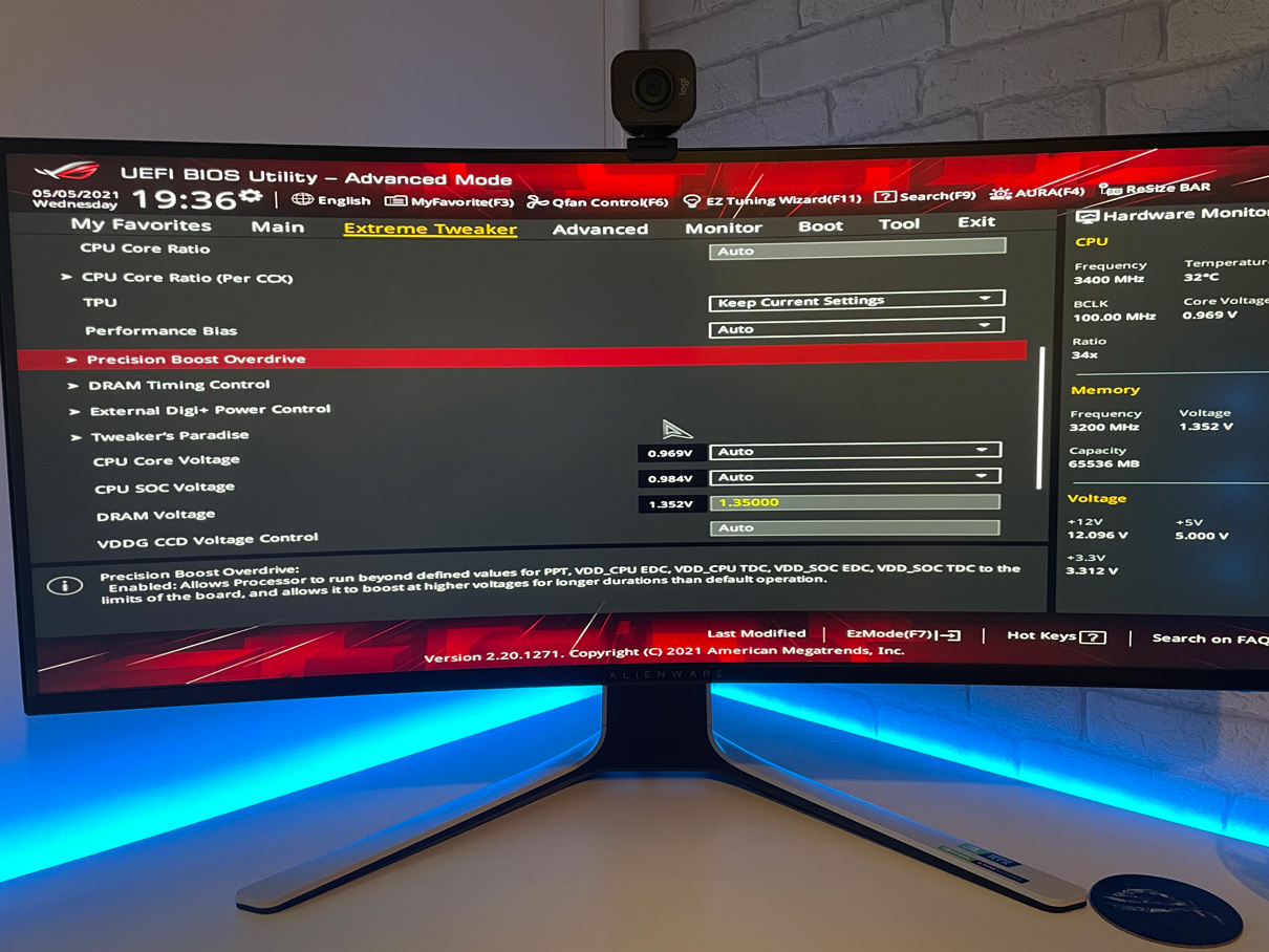

Right-o, here we go, screenshot dump incoming!
Extreme Tweaker has one reference to PBO - Enabled
Expanding confirms this is now set to enabled (under volting removed from manual menu entry)
Advanced has another reference to PBO - also set to enabled
RM now shows as default (initial launch still shows PTT, but a quick 'reset' from the lower left menu in RM changes this).
