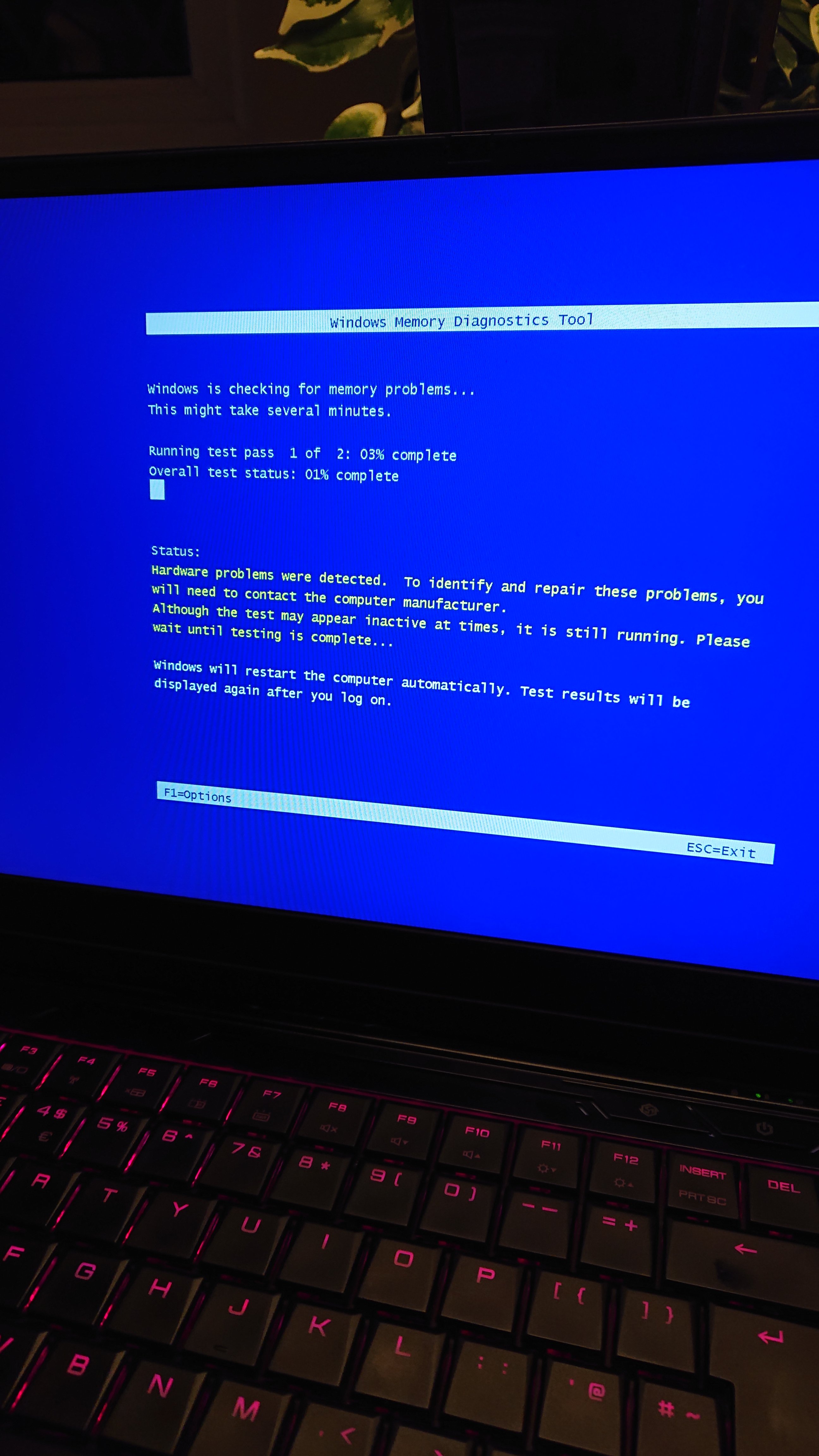

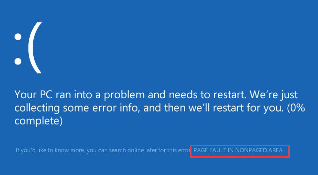

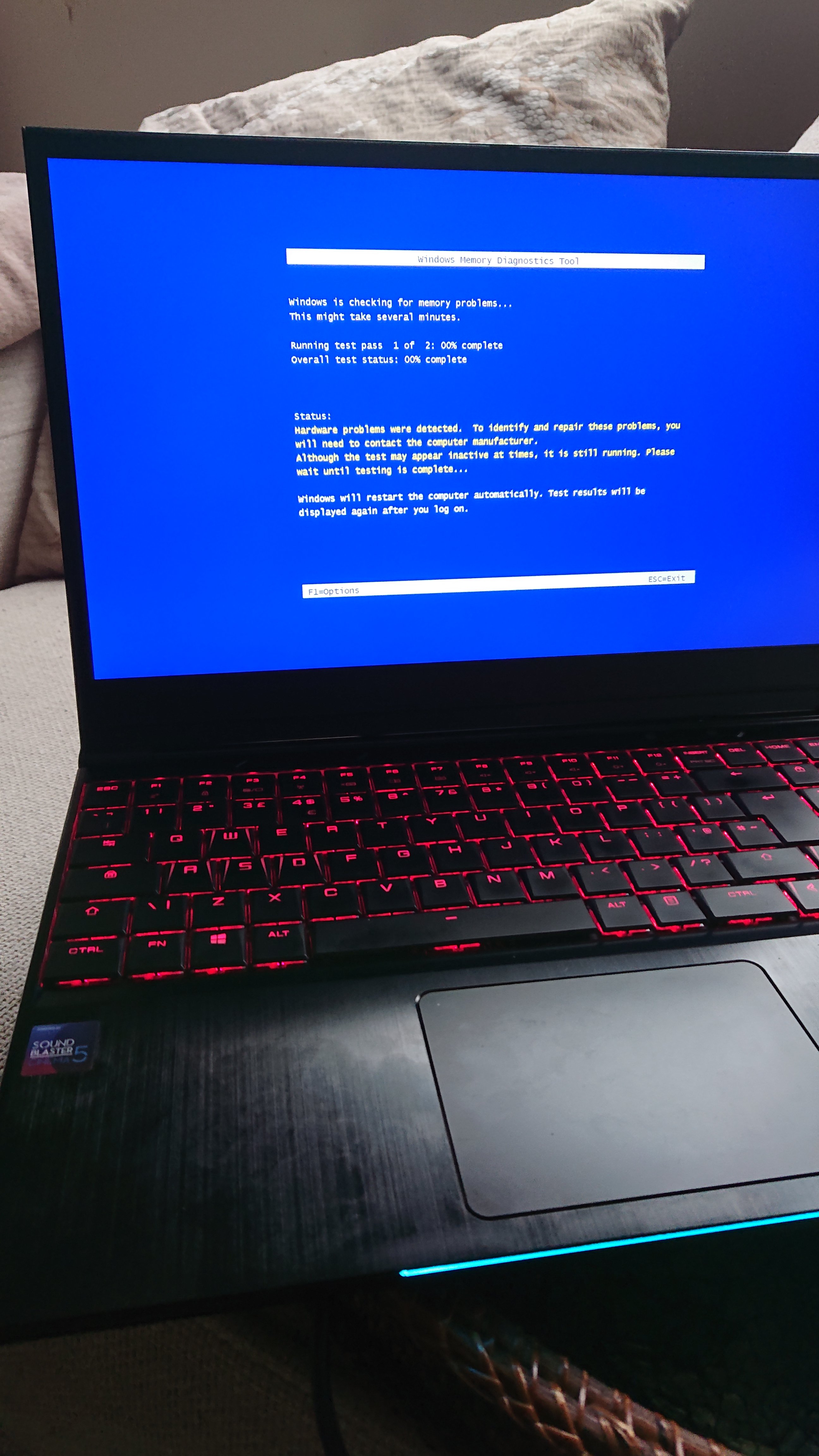

My machine which is just 1 month old has had BSoD from the start beginning with Watchdog violation which i updated firmware on SSD and seems to have fixed that but getting other memory management screens while just using chrome and downloading or very simple usage. I have really used its full potential much yet due to time. just been setting it up getting software installed etc. Did a memory diagnostic last night but got no report on it, took a pic, literally 0% in and said hardware errors. All pics attached of various issues. please help, if its RAM then I need replacement or advice, for a new machine this isn't great so far :( . The few render tests I have done show it preforms amazingly, 3 times faster than my old mac pro, so if it can be a stable machine I'll be very happy

Why have you waited a month? The first time you had a BSOD you should have been on the phone to PCS. Call them ASAP and talk this over with them
I agree that it looks very much like hardware, but it's under warranty so PCS will sort it. [emoji3]

May be worth unslotting the memory and reinserting it just to see if that clears the errors, but yes, I’d definitely log it with PCS also.

I'll be honest, its been long time since using a PC and BSoD has changed and doesn't look as intimidating as it used to, so as I've only been using intermittently thought these things could potentially clear up or once I started using it more regularly I would then deal with as I am now. But you are right I could have been in touch sooner. Thanks for you reply
No BSOD is ever normal, it's a last gasp desperate attempt by the kernel to give you some useful troubleshooting info before it collapses and dies. Do call PCS. :)
yeah PCS staff asked me to run memtest. Ran it for 14hours came back with over 10m errors, 40% pass rate. So sent the logs over to PCS for them to check and diagnose issue.

would you be comfortable to take the RAM out and run the system with one stick after another? It might be, that one stick is faulty but the rest is fine. This way, if it is a hardware fault at all, we'd be able to exchange the damaged stick of RAM with a new one.
yeah i can give that a go. Seems to crash with memory management BSoD when rendering out of after effects so that would be a good test. will try tonight. thanks
The best way is to run Memtest with only one stick in at a time. The problem with using something like After Effects is that you can't guarantee hitting every page of RAM.
ok. that makes sense. do i have to run it for 14hours though? how many passes/tests are enough to give a decent/accurate result? cheers

You'd run Memtest until it gave an error, or overnight with no errors would be a fairly decent indicator.
If you try 1 stick and get errors, and try the next stick and get errors, the next thing to do would be to try a different RAM slot in the motherboard. If both sticks give errors in slot 1, but neither gives errors in another slot, it could be a fault with the mobo.
So a fairly slow, dull and potentially lengthy exercise but a free one.
