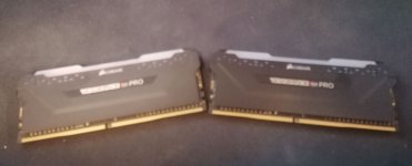

Hi. as you can see. removed 2 rams still having issue.

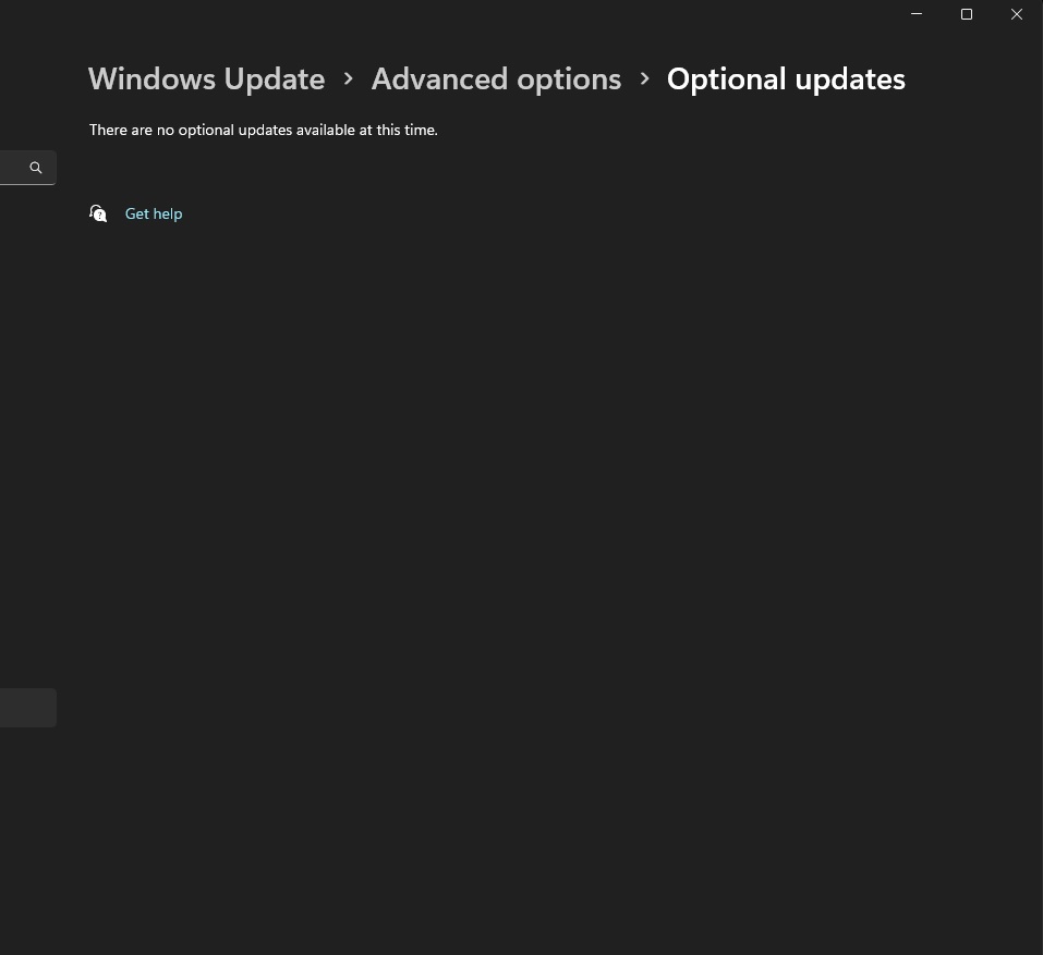

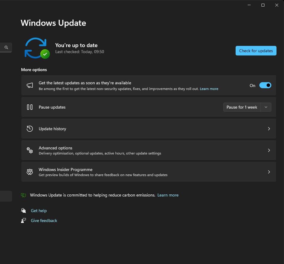

1. tried installing windows on firecuda in bottom slot. done all windows update, all optional updates. chipset driver. on latest version of bios. come to do a gpu stress test. crash.

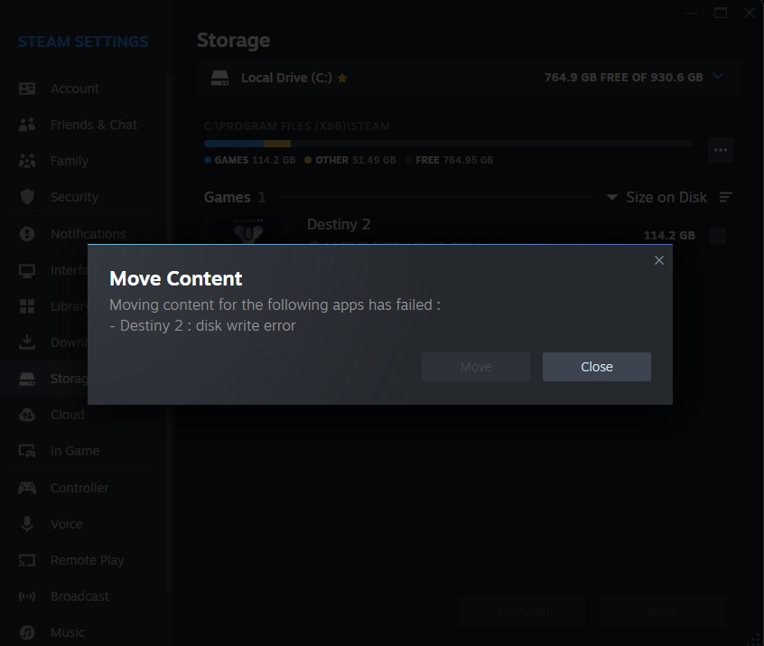

When install firecuda and run crystaldiskmark. Its not reading or writing. When trying to install Steam games on to Firecuda. It crashes.
Disk 0 Is PCS Nvme.
New Volume Is Firecuda.
When i try to copy any games over from PCS Drive which got OS to firecuda on or install any games onto firecuda that is the message i get.
As you can see. Everything is upto date.
