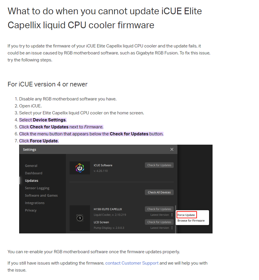

So the two fans on the radiator are showing the correct colour based on the selected colour pattern in iCUE, but the pump does not, is that correct? Sounds like one of the LEDs on pump is not working, for example, the blue led might not be functioning, which means that colours are not displayed correctly. For example, if you set it to purple, it will show red if the blue led is not working.
Edit: Have you tried force updating the firmware?
