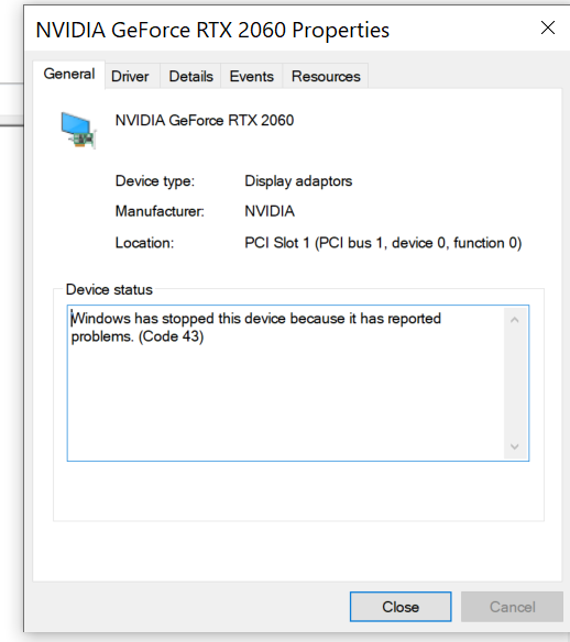

So device manager said windows has disabled my graphics card.
So went through BIG windows update. No luck.
Went through all update/replace graphics card driver. And, still the same...

We have now discovered that the main ssd with the OS is no longer recognised (damaged ?), and it will not boot at all.

It's entirely possible that the flaky SSD has been the cause of all your issues. Even the most complex set of issues usually has a single root cause.
You could try removing and reinserting the SSD, sometimes that helps. It's also worth checking to see whether the BIOS recognises the SSD.
The SSD failure might actually be good news. Permanent failures are much easier to deal with than intermittent ones. :)

Update - the laptop was returned. The Samsung SSD had failed, so was replaced.
