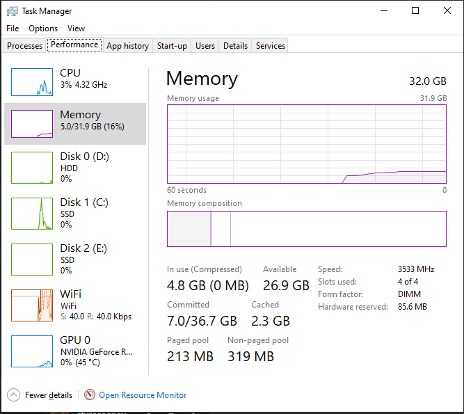

Installing other 2 DIMMS now and setting RAM frequency to 3533 in the BIOS. Will let you guys know how it progresses - expecting outages within 48 hours of running.
ChrisCooney
Looks good! Will monitor.
Just FYI - no crashes, left the PC on all night. 48 hours is a safe baseline but looking strong so far! No noticeable change in errors in the event viewer either.
Ooooo, looking tasty!!! (y) Performance wise there will be zero difference between 3533 and 3600 so this could be a real winner!
I'm sure Asus will release a BIOS update to address the 3600 DOCP profile at some stage, don't know why it's taken so damn long!
