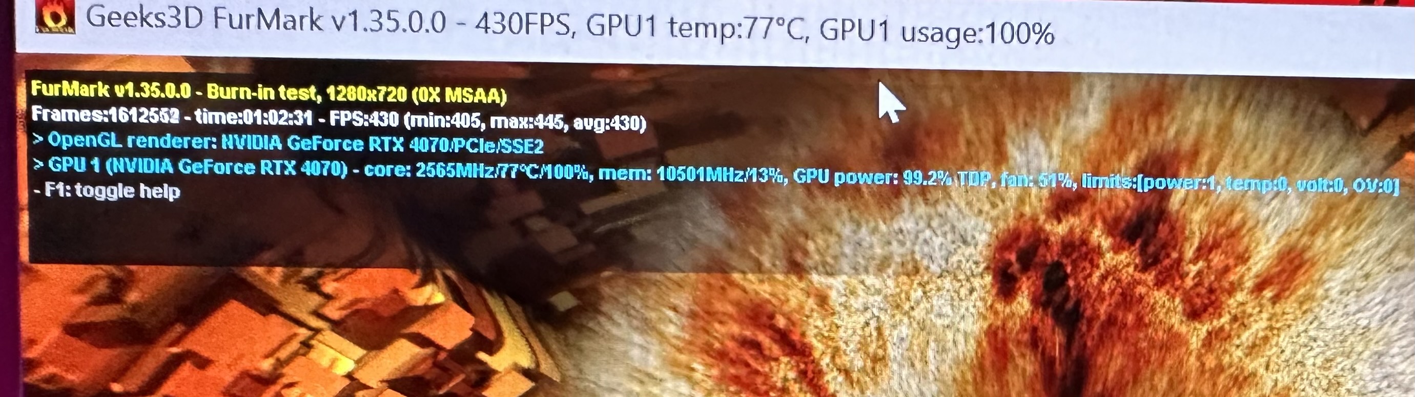

I think we should look at the GPU then. I would suggest you stress it with Furmark and see how it holds up. Download Furmark and then click the GPU Stress Test button. Keep an eye on the GPU temp (at the bottom of the Furmark display) and see whether it will run Furmark for an hour.

Vileblood86
This was after an hour. Though it wasn’t the usual resolution so illl probably try again at 1440p
I'm still not 100% certain that the graphics card is blameless. In your Application log there are some live kernel events...

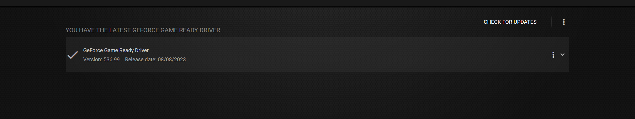

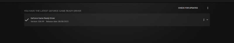

Vileblood86
There was a folder called WATCHDOG in the LiveKernelReports but it was empty.
I also reinstalled the Nvidia Driver shown here:
I didnt how do i do that?
To be honest, at this point, I'd be doing a clean windows install and then retest, troubleshooting at this level can be a huge runaround trying to find the cause, with a clean install, you know you're on a sufficient OS base, so you can rule out software as a cause
But if you want to carry on troubleshooting software, if ever doing driver maintenance, you always need to first clean it with DDU as there's no other way to properly uninstall a previous driver.
