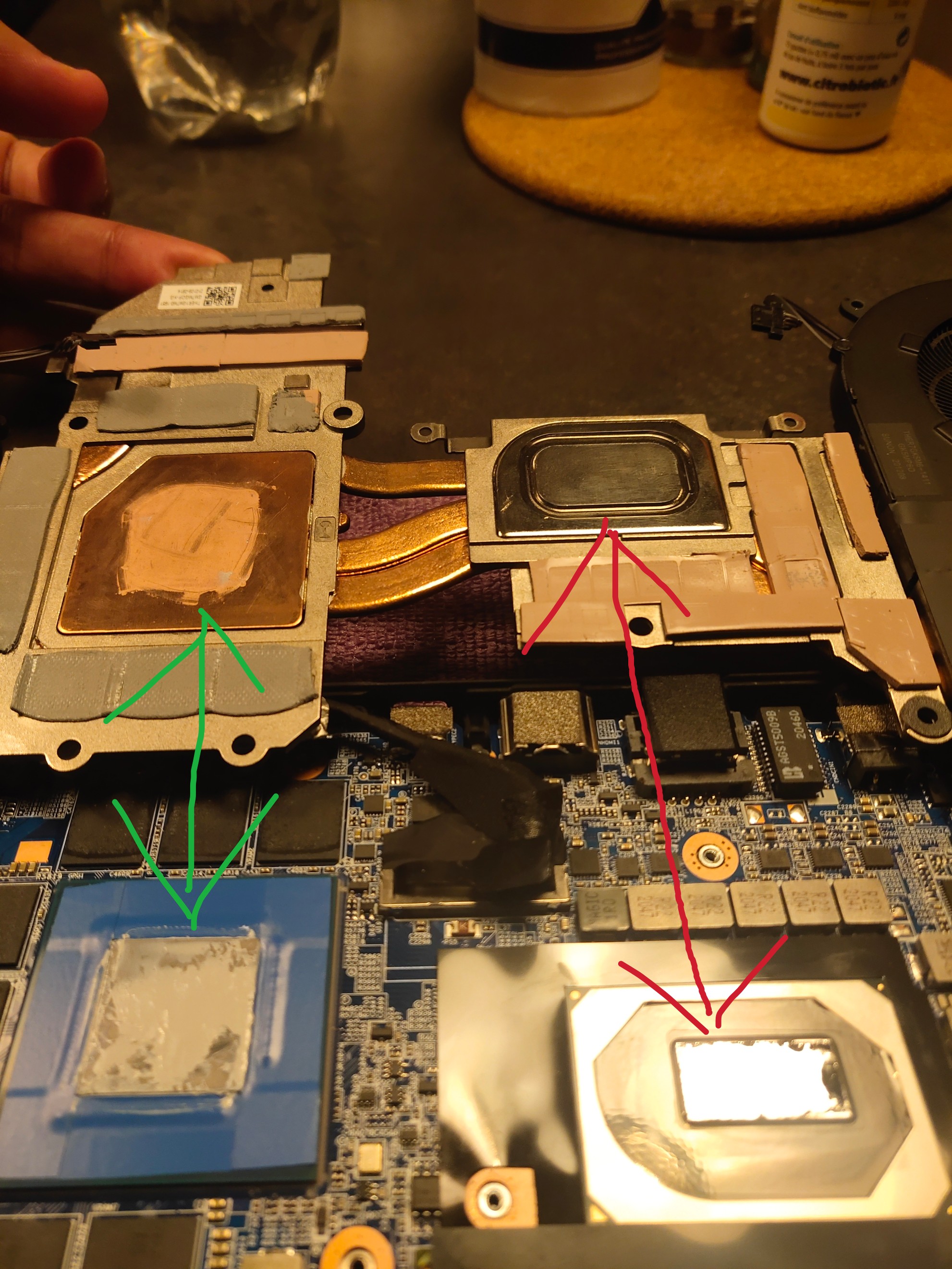

it is not the first time that I do it, I tried 3 times from 1 to 8 then from 8 to 1 nothing changes the radiator does not touch the liquid metal ...
barlew
When you took the heat sync off to apply the liquid metal did you notice whether or not the PCS thermal compound had made good contact with the IHS?
williamrichier352
yes I replaced the liquid metal with cryonaut I think the thermal paste is thicker than the liquid metal so strangely it affects IHS, I think there is a space of a few millimeters between the radiator and the DIE c ' is why the 10875h heats up on this chassis it must not be 100% in contact with the radiator ...

Probably this heatspreader (you call it radiator) wasn't thought for the LM. Infact it does not come with it if I am not mistaken.
barlew
On CPU, absolutely, not necessarily on GPU as they would normally have thermal pads rather than thermal paste which are a lot thicker.

Getting back on topic either that cooler is not being correctly fitted or there is something wrong with it.
Also on a side note I would not be putting liquid metal in a laptop unless it was specifically designed for it. But that's a personal opinion.

I then installed the IHS and then removed I can confirm that there is indeed a micro space in the cpu and the ihs because of the thermal pad so I transferred all the pads on the cpu side to install liquid metal and now the 2 have the touch perfectly I gained almost 20 ° c. the cpu no longer exceeds 71 °,
I put liquid metal because I find that the radiator on the cpu side and well designed for I just wonder what material it is and made if anyone has an idea it does not look like aluminum?

I am mega confused here. What do you mean by you transfered thermal pads? I hope you don't mean you removed any of the thermal pads shown in your previous picture? They are providing heat dissipation to other chips on your motherboard not your CPU...
