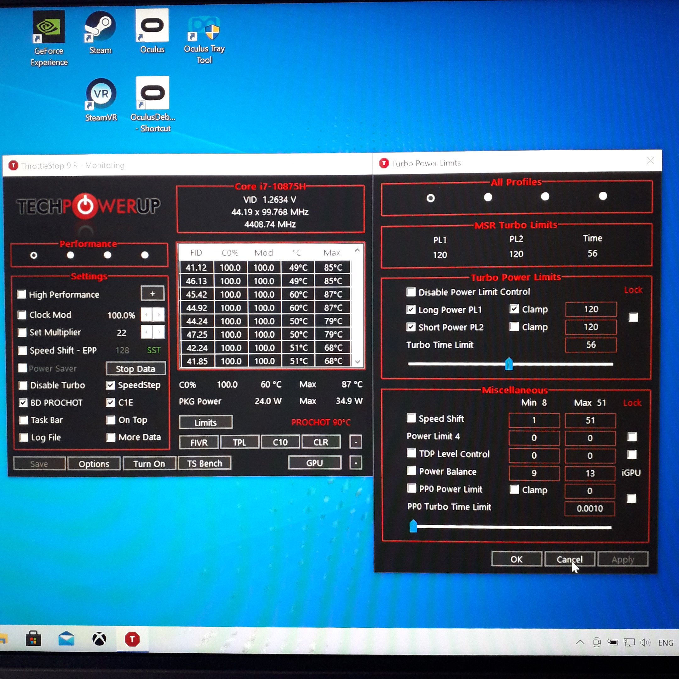

I launched TS again. The undervolting has reset to zero. However the PL1,2,4 numbers are the same as I last showed (new pic attached) where we thought I had made an error. When I did my early changes I took photos of screens before changing values so I could reset. I did not take any of that screen on TS and I believe they were the same as another users was. So in short, I am reasonably confident I only undervolted.
I am now on CC game mode with CPU PL1&2=35w and PL4=165w. Not sure why TS has defaulted to the values in the pic?
My subsequent posted improvements were after dropping CC values. I believe @Macco said TS sets a hard limit CC works within? Again in short I think my problems were caused by my CC settings rather than TS? Game mode was essentially set to turbo with a CPU temp throttle at 90degC.

Yes, provided you are using CC 3.x, the TS PL limit won't be reached, you'll be using the PL limits of the CC current profile. And CC can't exceed the PL limts set in TS, so it's a good idea keep TS limits high with no risk.
It should be fine as you have.
