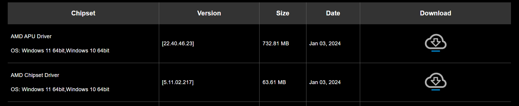

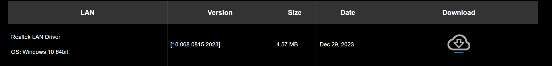

The admin of the server hosting Ark suggested me the following to resolve the issue:
Start of quotation
here are all your drivers if you can make sure they are installed
run through those drivers update, then reboot.
the 2 for chipset i would look at and see is for the chipset
the LAN
End of quotation
What do u think ? Is it risky to update these drivers ?

Matxer
It's not even clear which drivers I should download. There are drivers for rev 1.0 1.1 1.2 1.3...
How can I contact PCS ? I need a person skilled on that subject.
