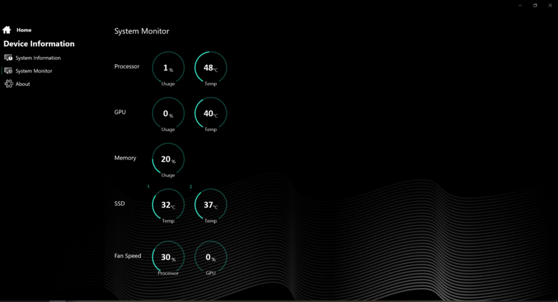

This is with the cooling pad turned on and after the same conditions as above, as you can see by the screenshot and the breakdown, this pad actually DID make a difference compared to the other two that I reviewed and the laptop physically felt cooler compared to when I was testing with the other two coolers.
CPU was around 44-46 degrees. I did see a drop down to 42 degrees on the odd instance and a spike up to 48 degrees but seemed to stick around the 44-46 degree area for the most part.
GPU was around 36-38 degrees with some spikes up to 40 degrees like in the screenshot.
SSD's were 32-33 and 36-37 degrees.

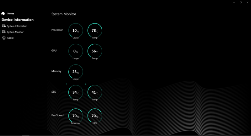

The below is with the same conditions as above but with the cooler turned on:
CPU 78-81 degrees
GPU 56-58 degrees
SSD 34 and 41 degrees
So with the cooler on, the temperatures were the same or a degree or two lower under load as with the cooler off.
