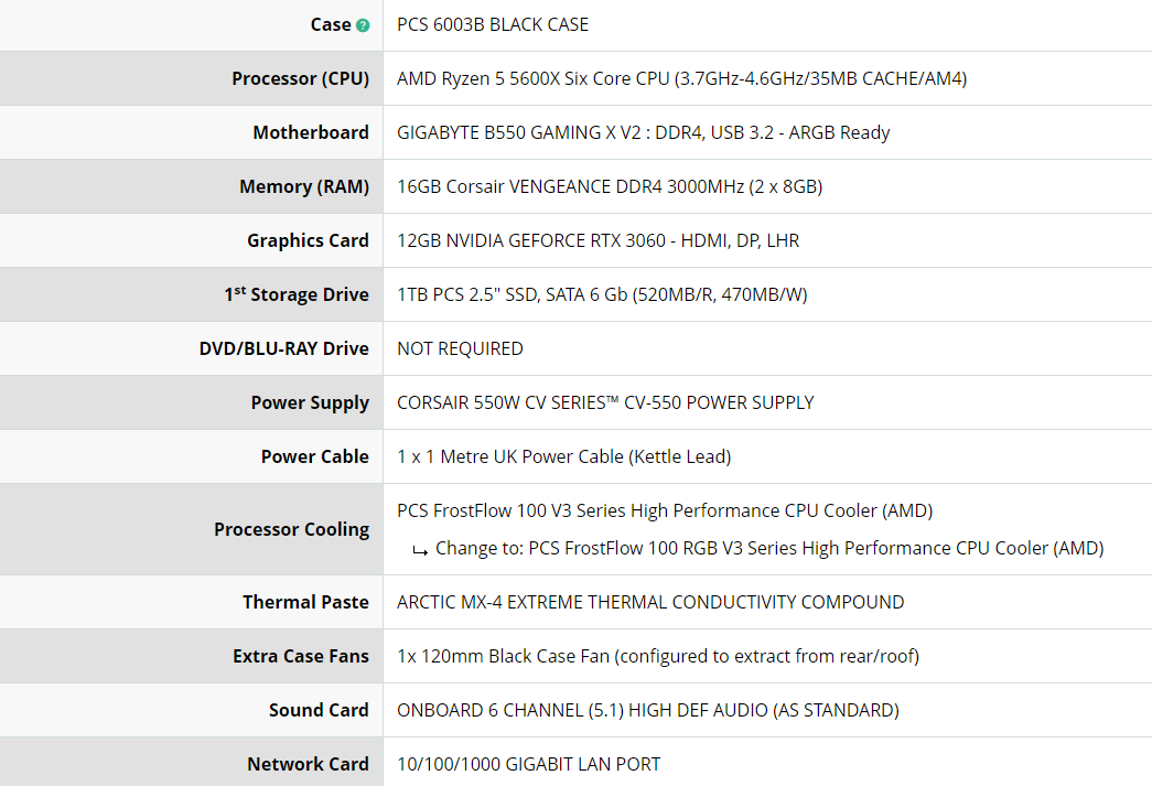

can you post the full spec from your orders page, so we can see exactly what we are dealing with
Hana
Yup no probs, I'm desperate to find a solution because everything that I have tried just hasn't fixed it (making sure the pins are in, reseating GPU/RAM etc)

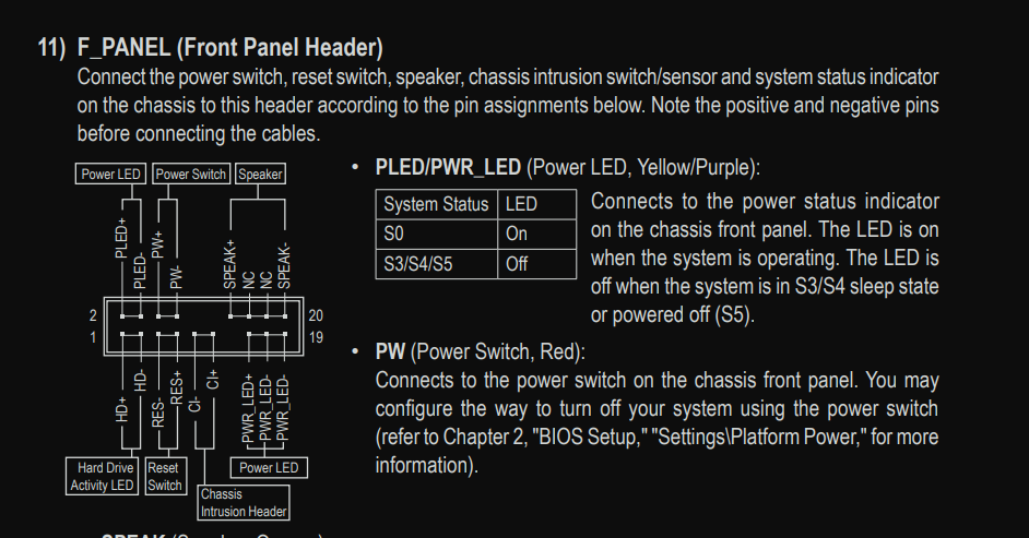

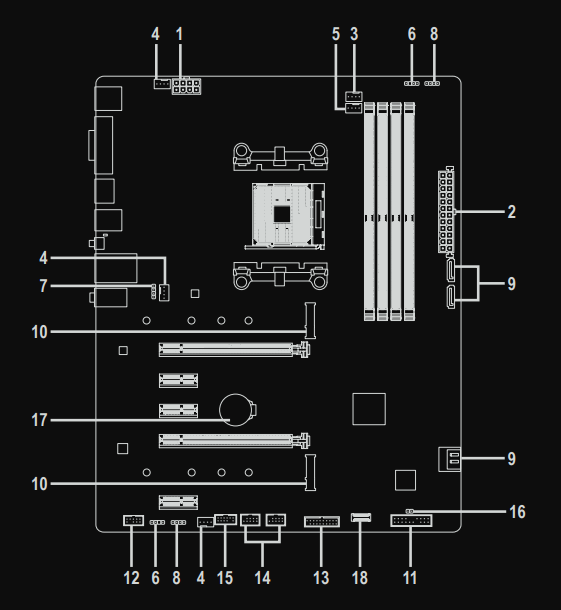

Hold on, there is one other thing to try, the power button on the case is plugged into the motherboard with a tiny 2 pin cable, just make sure that's inserted properly (one labelled Power Switch) also make sure the polarity is correct:
It's number 11 on the board:
But failing that, it means no power is getting to the board. Nothing really you can do.
