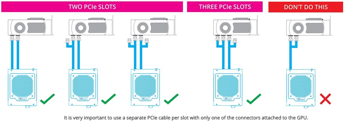

Do make sure that your 3080 is using 2 separate PCIE cables. If It was using a 1 cable with 2 6+2s on it or whatever, you'll need to plug in another separate one into your PSU and then unplug the 2nd 6+2 coming off of the 1st cable, and plug in the 2nd cable that you just plugged into the PSU. It's very important as 1 cable is not enough to handle the 3080 with stability. Hopefully they've corrected their mistakes in building, but they were only notified of it yesterday after I mentioned it and corrected it myself by plugging in another separate one from the PSU
It can look like any of the other diagrams, just not the one on the end, which is what they did for me, and i assume others could have the same issue.
Thanks. That was useful. I only had the one cable connected. Now I have two. Wow, that was fiddly. There's a reason I don't build my own. :)
Its a shame this wasn't in place before the build with all the public messaging about the power draw of the cards.
Appreciate your thoughts, Alex.
I would let PCS know via email as this shows that it isn't an isolated incident. PCS should hopefully be able to go through their records and contact the customers who have purchased such a setup to check if the cabling is in fact in correctly.
