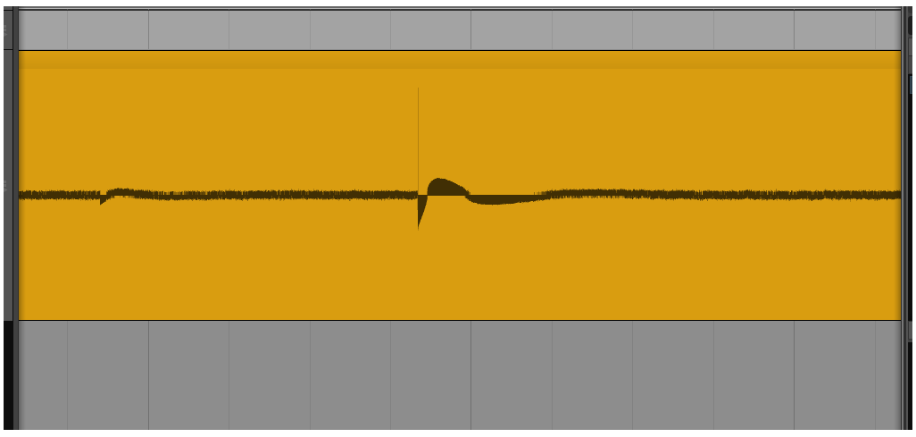

I've recording the click directly from the source - this is heard every 10s or so from the headphone output:
And this is what the waveform actually looks like:
In audio world that could very much be something to do with voltage... To be continued.
