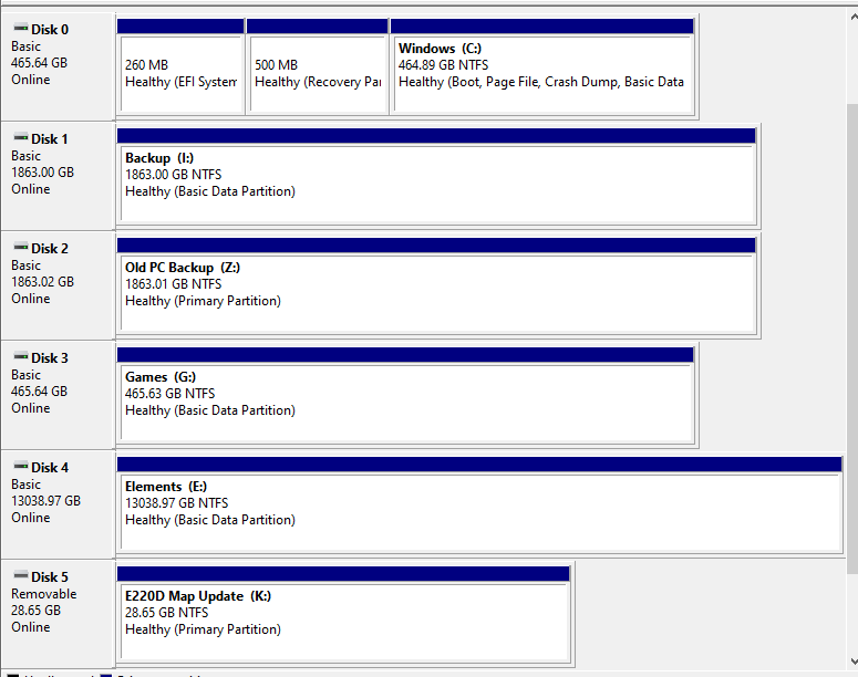

Ah, that's my K: drive - a 32Gb Sandisk Thrumb drive.
I have a KVM which I use to share my Mouse, Keyboard & this drive with my Desktop(PCS) & my work laptop.
I assume when I switch to the laptop using the KVM, the drive goes missing in the PC system & that's why it complains.

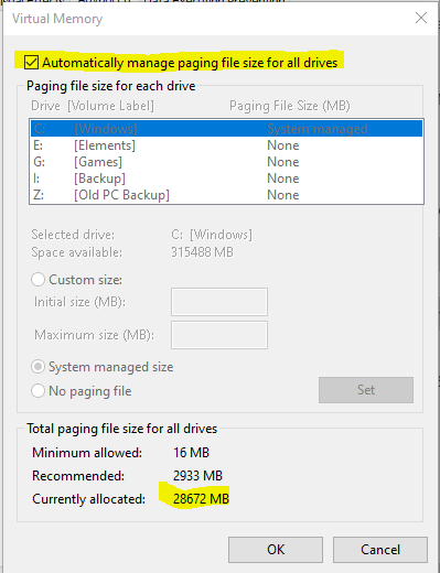

Paging file is 28.7 GB, managed by the system e.g.
If that's how things were with the paging file I would check your C: drive too.
IMO it's not wise to use a thumb drive as any kind of permanent drive. There's no doubt that Windows was having problems with that drive. Are you sure a paging file didn't find its way on there?
It's unusual to see two unrelated problems so I'd investigate your paging issues very carefully. Problems there could easily be causing the problems you report.

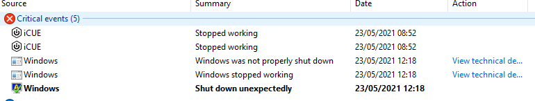

Hi,
I've been away for a few weeks, PC has been off till I came back on Saturday.
Just had the first freeze since I returned, approx 10:44.
I've removed the KVM, PC & Laptop have separate KB & Mice, I did this on Saturday before today's freeze.
They share the dual screens, PCS on DVI, laptop on VGA.

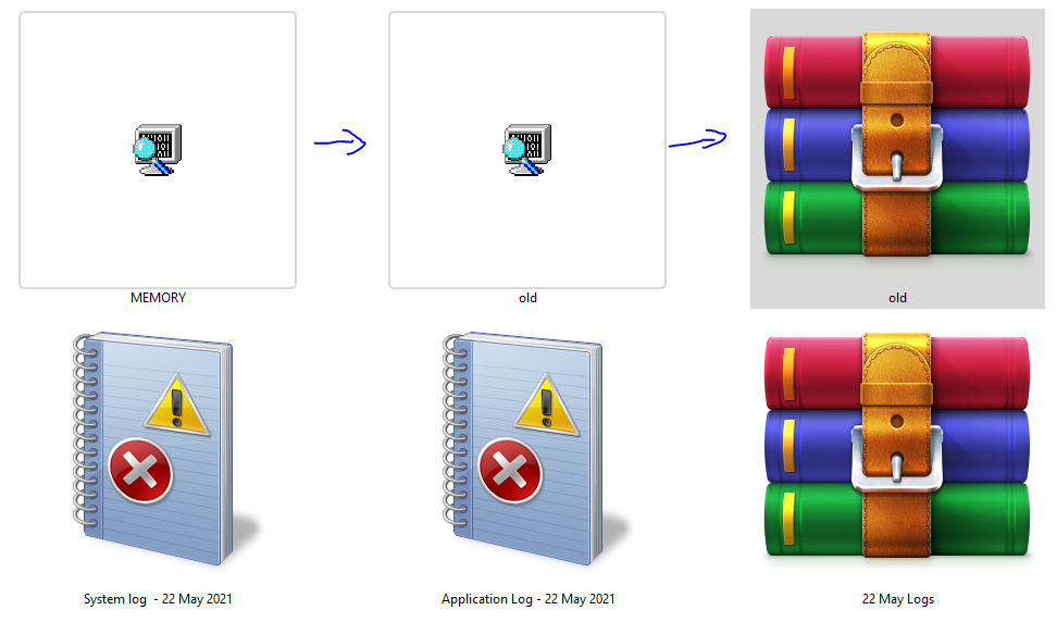

System froze, and I managed to induce a BSOD with the keyboard short cut.
I've uploaded the event logs to here : https://1drv.ms/u/s!AoUU74i2sEO7rl-FhbOHhrup5H3z?e=o6KCza

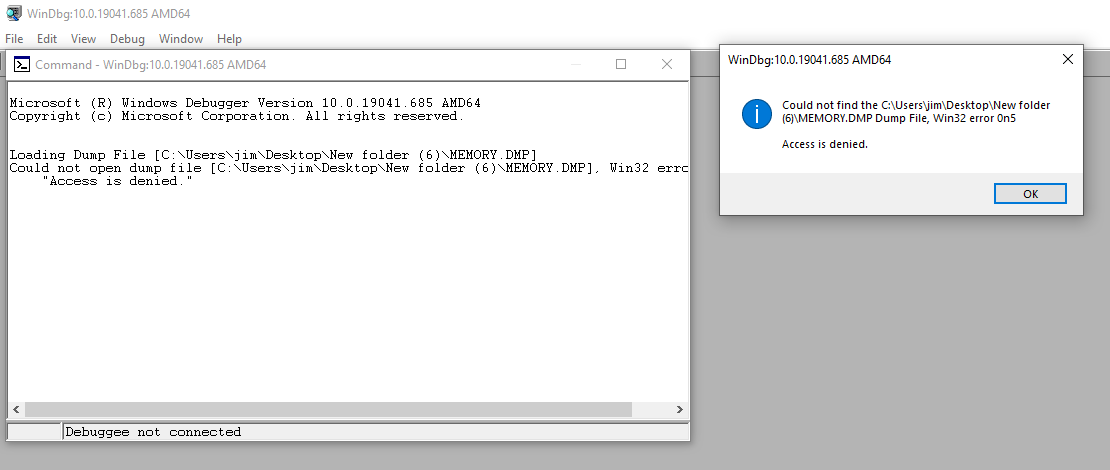

The MEMEMORY.DMP file was a bit weird, it wouldn't lt me compress it initially or even open it.
I managed to copy it sideways to old..dmp, then I could compress it: https://1drv.ms/u/s!AoUU74i2sEO7rmGcn7bvgQKcKcO3?e=2gmORD
Ok, I'm not sure what's in which uploaded files ;) but I'm downloading from both links. I'll get back to you on what I find - most likely tomorrow now. :)
I've got the kernel dump ok but I'd forgotten you were manually initiating it from the keyboard. Unlike a normal dump where the active thread is already isolated I'm going to have to trawl through every process, locate the active threads in each one, and then look to see whether any of them has stalled. That will take a looong time and probably several days.

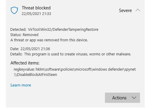

Removed Norton 360 & Norton Utilities, much to my suprise, after a reboot - Windows Virus Protection didn't start Automatically.
Had to google how to get it to restart it, now have windows Virus & Firewall running.

Looks like defender found a reg value which had been setup to stop defender from restarting e.g.
Not sure if Norton left it behind or somethere bit of malware,

What happens when it freezes? It would seem that the keyboard still works? What else still works when it freezes?
Are you able to note down what was running and what you were doing when it froze?
I've spent some time trawling through the 250-odd processes you have running and nothing has looked out of place so far.
