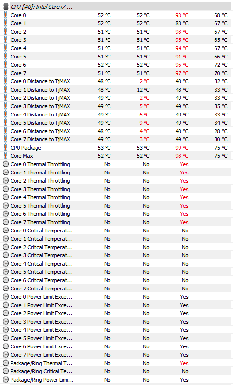

Thermal tests are available online for the Eluktronics Max-17 and it's quite hot under load. As expected it reaches 90+
I think it's simply impossible to have a 20mm laptop with a cooling system capable of cooling 8 cores properly.

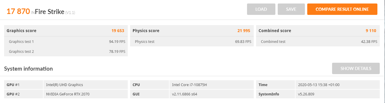

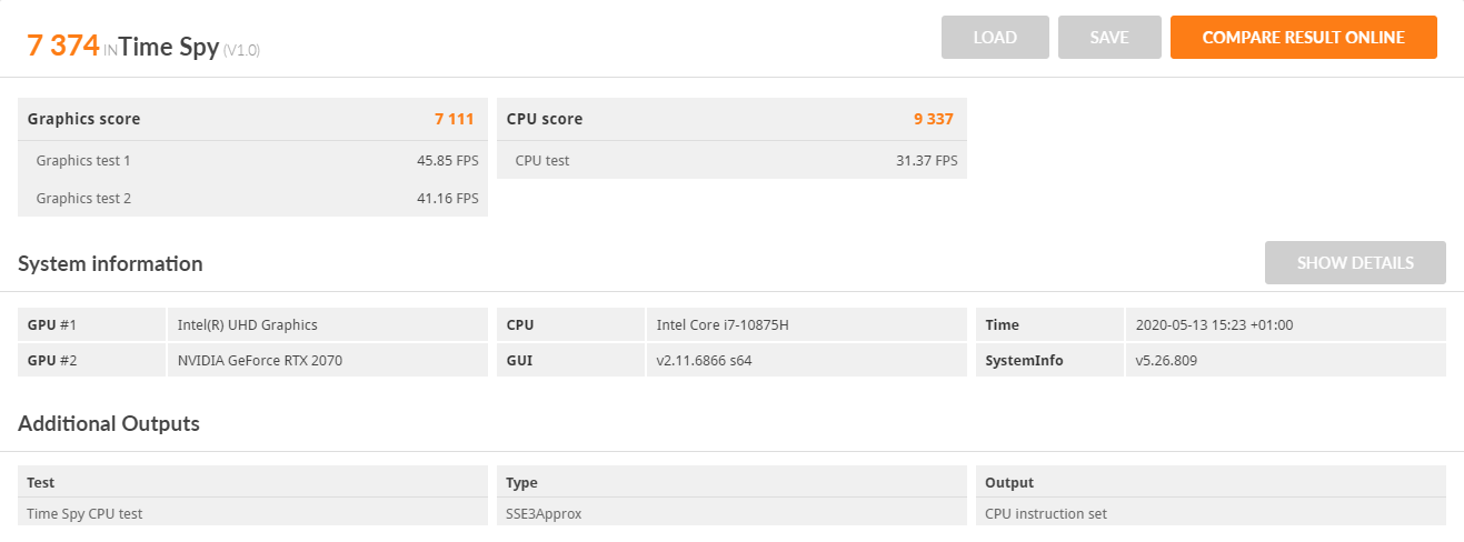

Okay so I have no idea what any of this means, but I ran those two tests.
Time Spy:View attachment 16073
Fire Strike:
Before you apply an undervolt you need to be sure the paste job is sufficient, otherwise you’re not addressing the core issue, just masking it.This has been done on stock settings for cpu? I assume you did not undervolt anything? As you can see, it just prooved what I have said. Try to apply undervolt if you know how to, and run some less stess test, for cpu such as cinebench r15, after undervolt it should perform much cooler and also better.

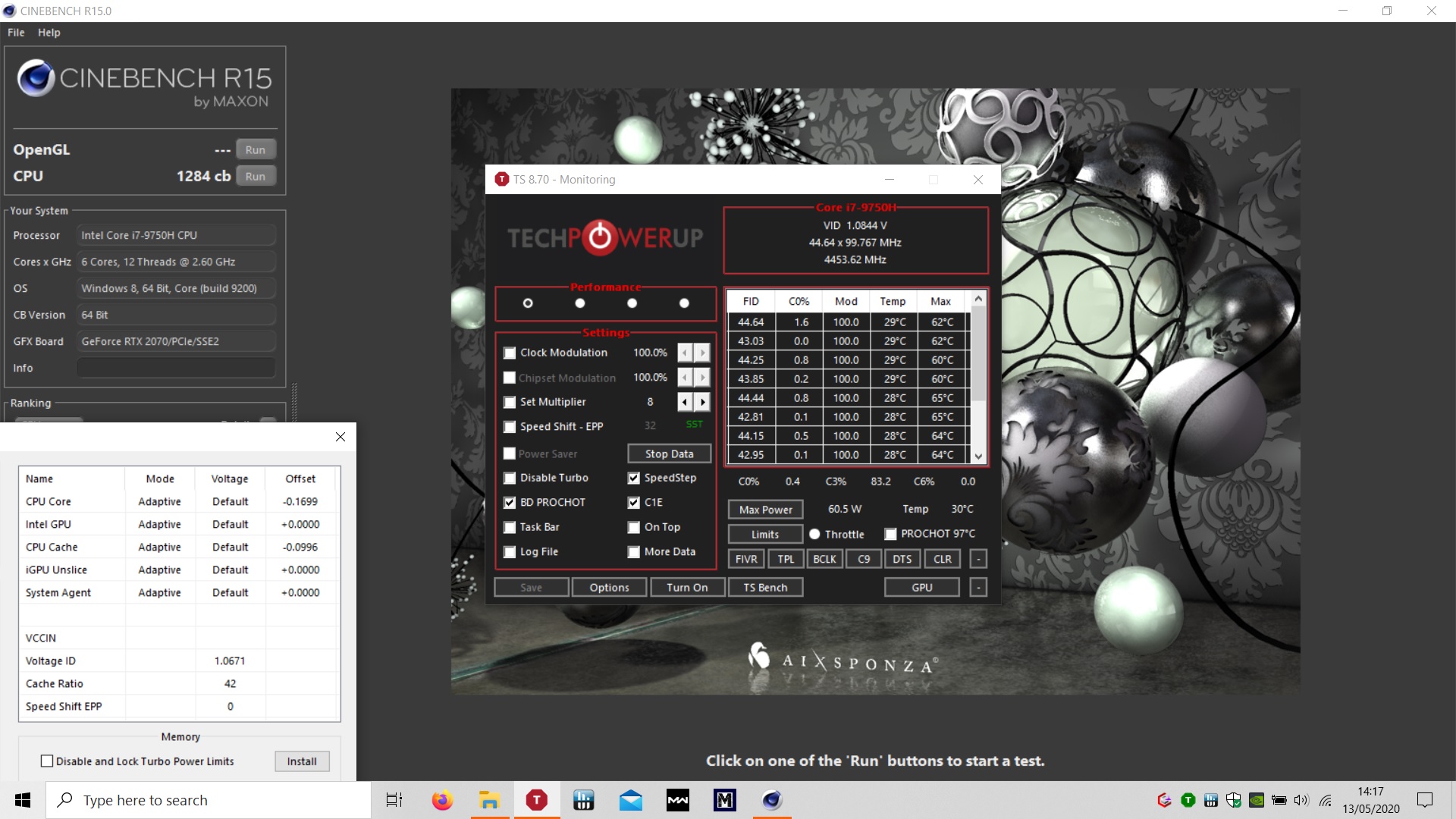

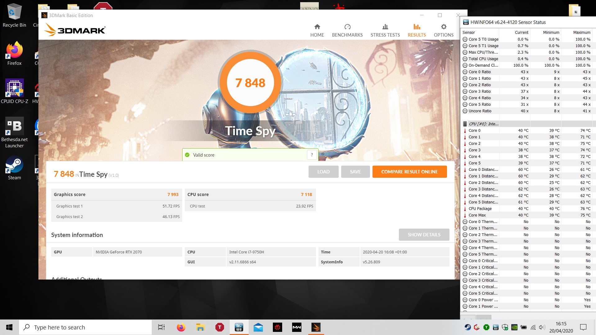

Just to compare yours and mine, with -100 undervolt. It helps a lot and this is 15inch laptop, but with -2 less cores, but also as you can see your cpu score is much higher than mine 6 core 9750h
