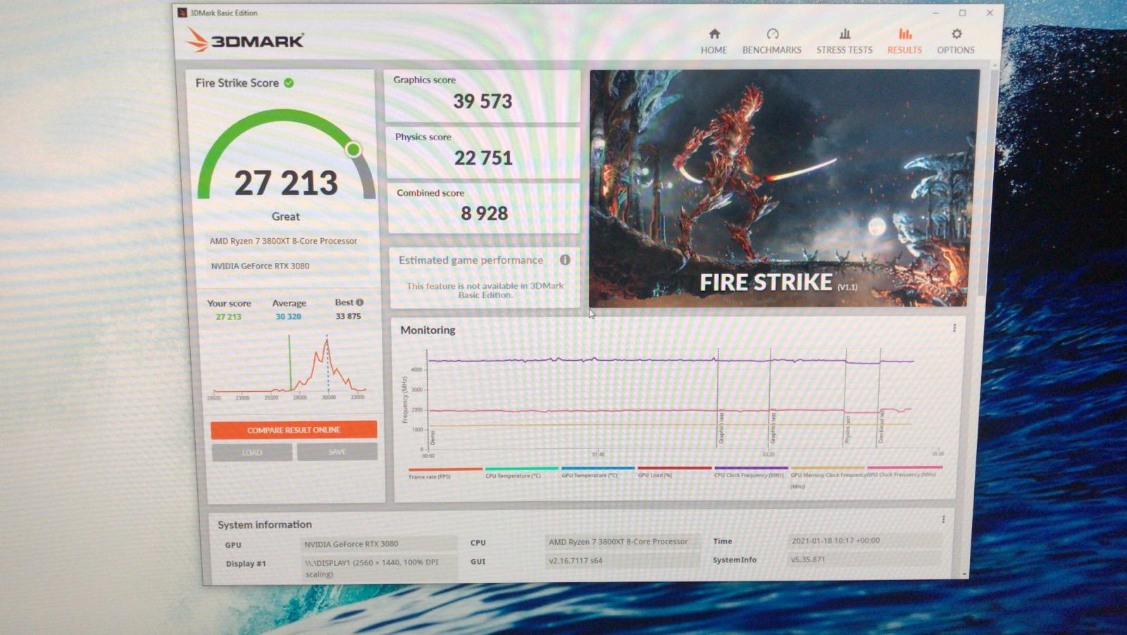

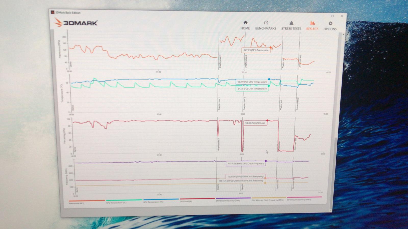

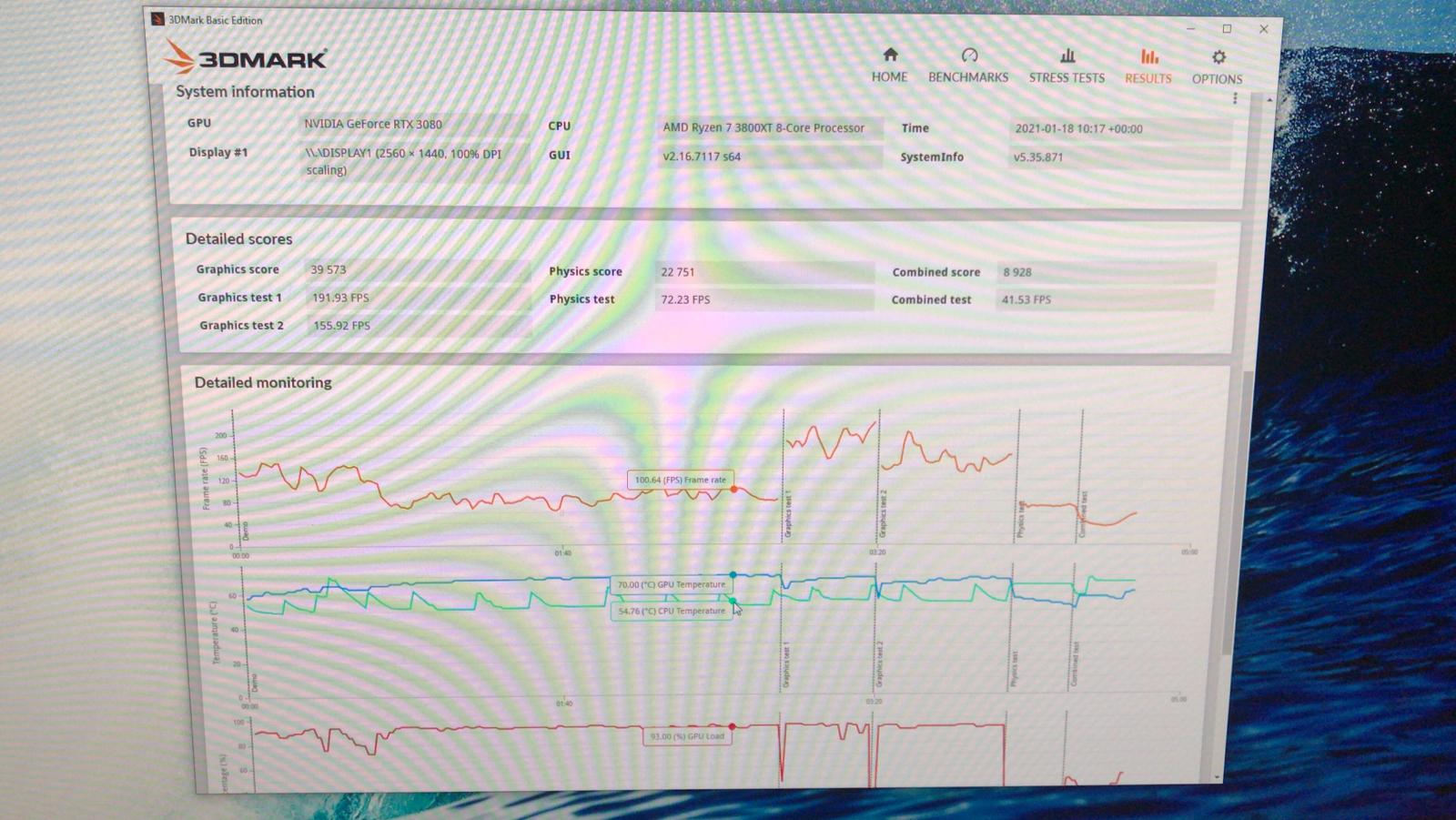

Thanks guys. I ran 3dmark Firestrike just out of interest. Do the results look ok for the setup?

Bhuna50
Click on the compare results online and then post the link here as that will give more info to look at for you.
I have hwinfo... ram clock 1054?
Definitely needs the profile enabled in the BIOS.
When the system is switched on there should be a function key to enter the BIOS displayed. It's normally F2, F10, F12 or Del. If you go in there, then into the Memory config, you should be able to enable the XMP profile in order to set the RAM to 3200. This should have been done already but it's sometimes missed.
Slightly off topic but I never understand why they test a system with XMP disabled (I assume that's the case given we get systems sent out without XMP enabled)...surely you test it at whatever speed the customer is going to be running it at? Unless they test it with XMP enabled and then with it disabled maybe? Always found it odd
It always should be. I can only guess it's sometimes missed, possibly with the throughput required right now. Even the training element will be strained I imagine.
thebailers
Thanks so much guys. All else in the system looks fine to me? If something else wasn't configured properly, would the hwinfo/benchmarks show it?
