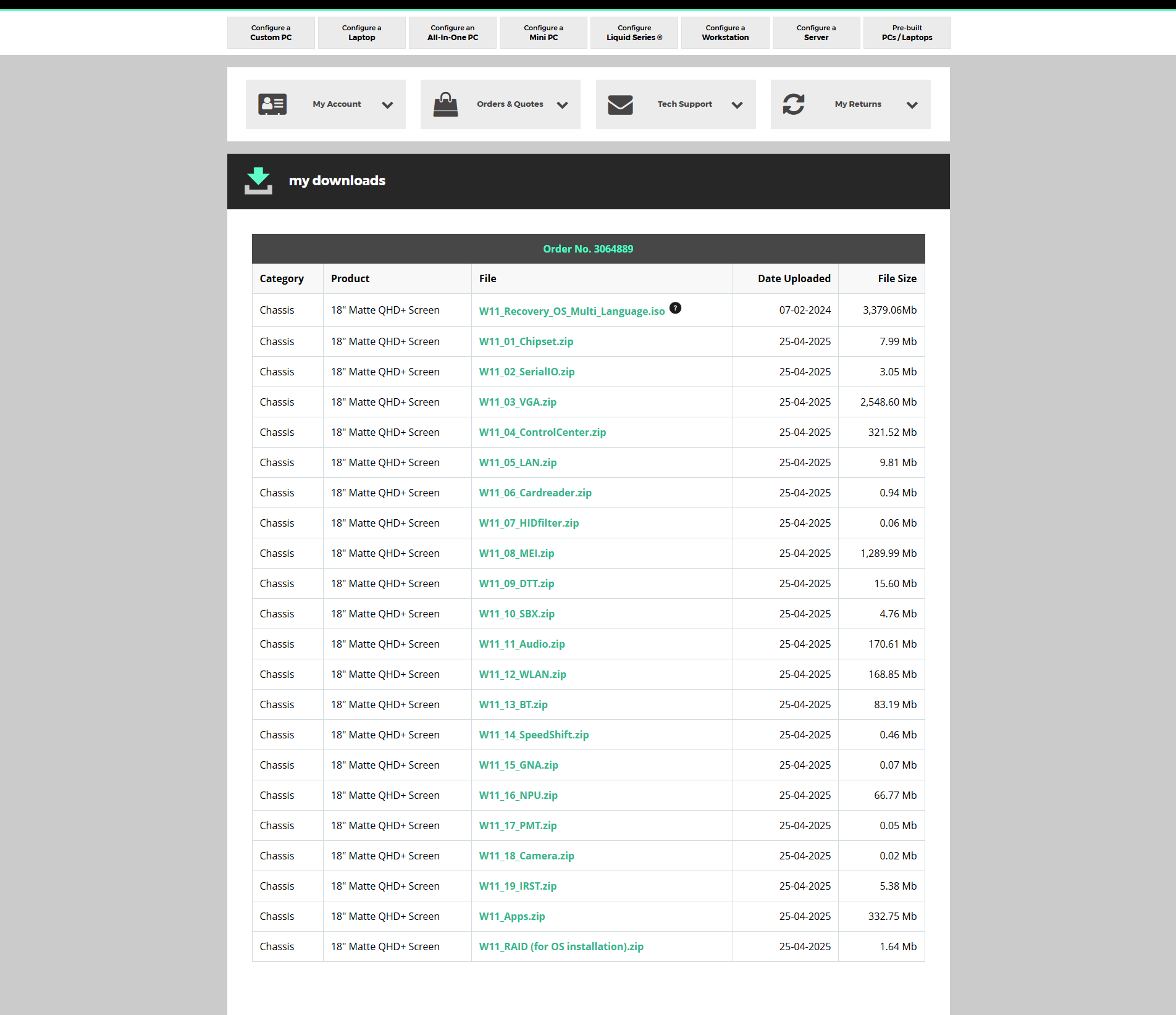

Download the Chipset Driver & Control Centre so that they're ready to install after Windows has done it's first installation.
Do you have a screenshot available of the downloads in your account (The PCS account). Just so that I can see if there's anything else you should have ready.

Ok, did you install the chipset directly after installing Windows? You need to help us to help you, the more information and feedback we receive the more we can pinpoint what could be wrong. Right now, the only information I have is that you've installed Windows. I don't know the process you went through or if it was what was suggested?
Full clean install with all partitions removed.
Immediately after install, chipset drivers installed along with the control panel.
Once installed, allow Windows to update all drivers and install all the latest patches etc (multiple restarts typically).
Install optional driver packages from Windows update.
Serial IO may relate, but that's typically a UART driver. If you install the Intel discovery tool after the above that should find any missing Intel specific drivers that Windows hasn't updated.
After that, we can have a look at your Device manager to see which devices are missing and start to investigate them individually. I wouldn't recommend installing any more of the above unless specifically required.
