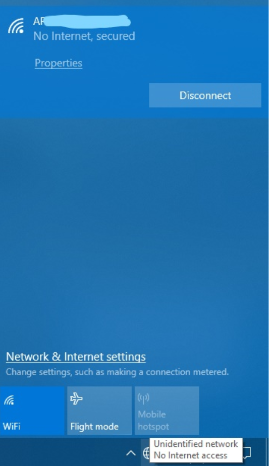

Just followed the driver advice once again. Went to Intel website, downloaded latest driver to desktop. Uninstalled. Restarted. By the time I was back restarted the driver seemed to have installed itself again....I assume via Windows. Situation was still the same.
So I tried a different method. Uninstalled the driver. Unplugged ethernet. Restarted. Then installed driver via download on desktop. Once installed, still the same.
Strangely, when hovering on the icon in taskbar, it showed "Unidentified network" yet the SSID of the network still showed.

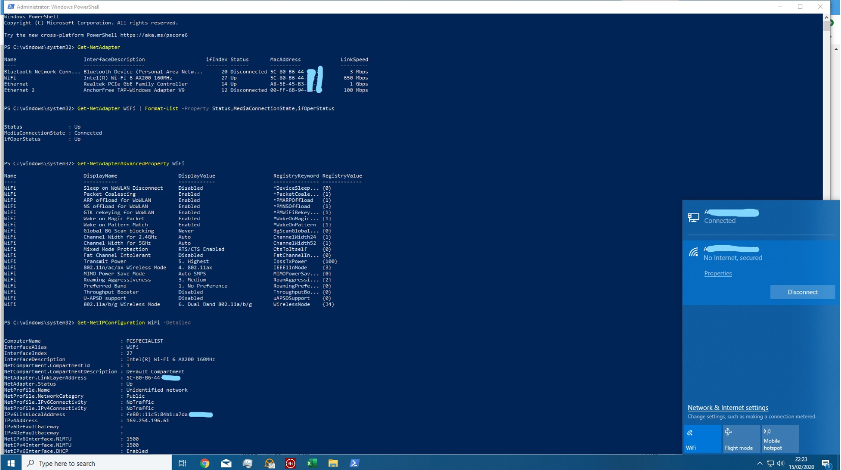

I think it might be worth just checking where we're at now. As I understand things the problem has been narrowed down to this....
1. Everything works normally when Ethernet attached, including remaining connected on waking from sleep.
2. WiFi connection works normally until the PC sleeps, on resuming from sleep you have the "No Internet, Secured" message (and we've established that's because DHCP fails on resuming from sleep (you see the autoconfiguration address and no gateway in ipconfig /all).
Is all that true, or is there more we don't know?

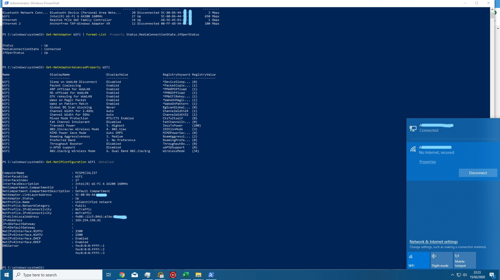

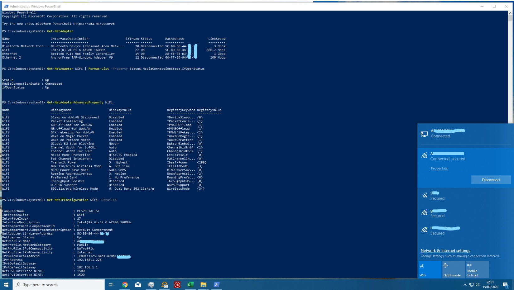

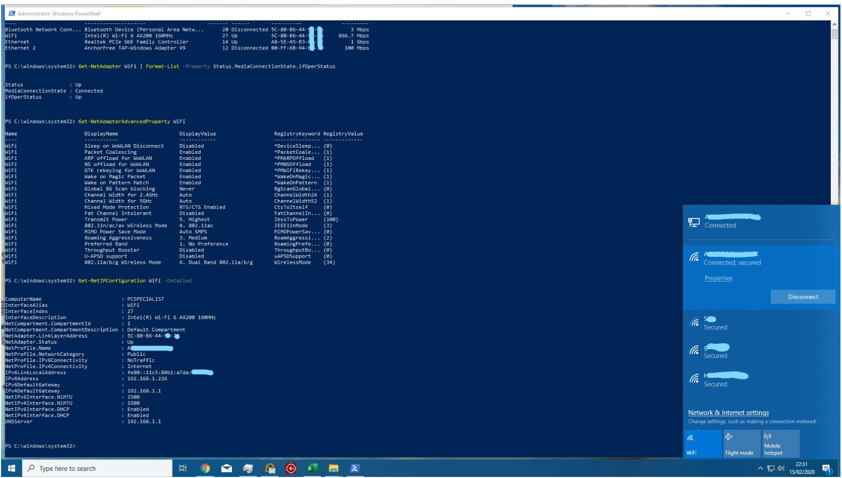

I'd also like you to run the following PowerShell commands using Admin mode (ie. elevated) when connected via the WiFi adapter both when you're having the No Internet, Secured issue and again when everything is running normally. Note they are not case-sensitive.
Get-NetAdapter
This command will produce a list of your network adapters and their names. Find the name of your Wifi network adapter, you'll use this in the next commands. Note: You only need run this command once, the WiFi adapter name won't change.
Get-NetAdapter WiFi | Format-List -Property Status,MediaConnectionState,ifOperStatus
Replace WiFi with the name of your WiFi adapter in the above command. It will show the status of the three properties listed. Take a screen shot of this output and post it here.
Get-NetAdapterAdvancedProperty WiFi
Replace WiFi with the name of your WiFi adapter in the above command. It will show you all the advanced properties of your adapter. Take a screenshot and post it here.
Get-Net-IPConfiguration WiFi -Detailed
Replace WiFi with the name of your WiFi adapter in the above command. It will show you the detailed IP properties of your adapter. Take a screenshot and post it here.
andrewstevens556
Yes, as far as I am aware that is all correct.
Thank you. OK, first up "No Internet, Secured"
EDIT: Screenshots removed as messed up a command - screenshots to follow below....
